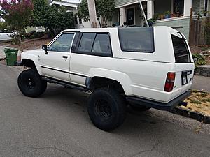

Hello, just got my 1985 4runner! Attached a pic!
Took it to get smogged and it failed, apparently has the PAIR system removed! Then it gets more confusing because it's an 85 EFI truck, but the smog guy says it has a newer engine and smog system, even a different distributor than 85. The guy I bought it from did get a new rebuilt engine recently, but said it was just the long block.
I did confirm that the egr is still on there, but the smog system that bolts to the driver's side manifold isn't there.
My question is if a smog system from a 92 will have the same fitment as mine? There is one on ebay for a 92 that isnt bid up much and I thought it couldnt hurt to buy it:
https://m.ebay.com/itm/1992-Toyota-2...-/132323726742
Any ideas?
Scott
