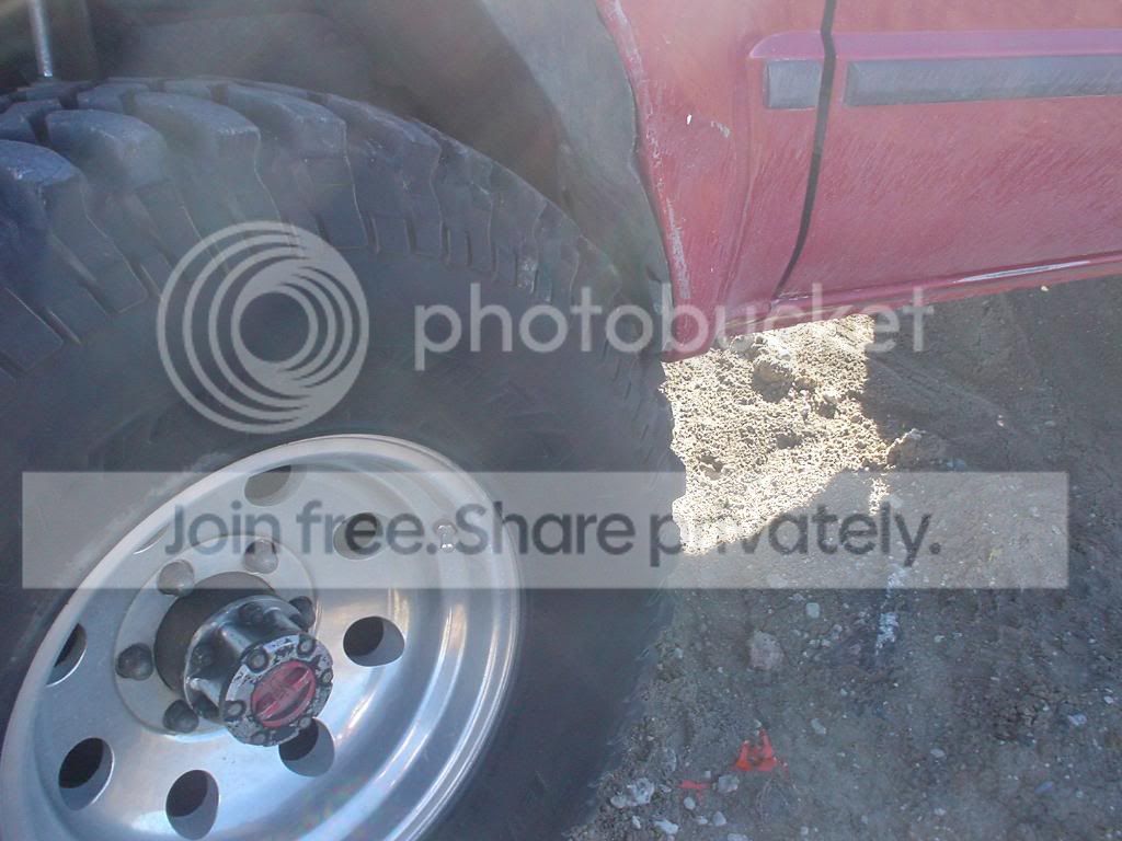

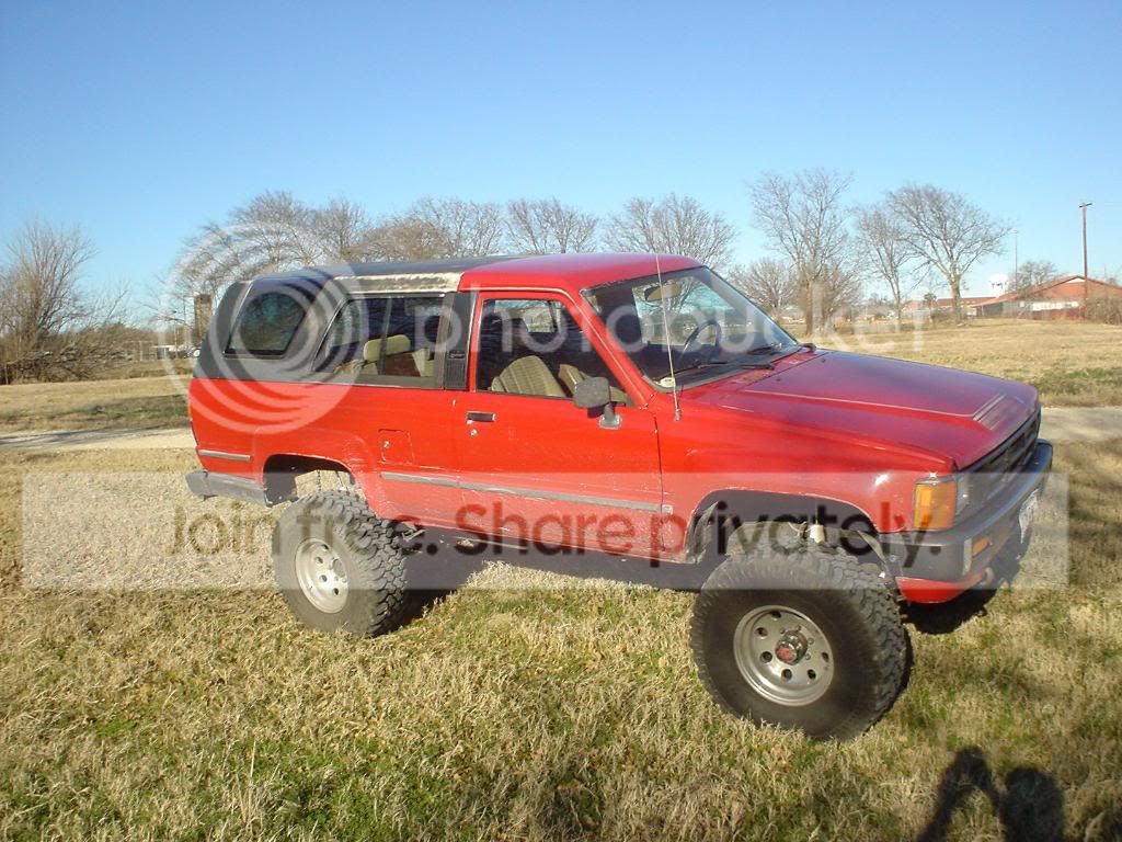

I have 5" lift on my 4runner with 33" tires. I plan on running 37" someday that why I went with 5".
Here's a picture of how close it come to the fender. Consider moving the axle forward, I wish I had when I installed the springs.
If you can, get cross over steering, I have real bad bump steer with a drop drag link.
As far as gearing goes I've run 33" tires with 4.11 gears and pertty much lost 5th gear, and gave the clutch a pertty good work out. Good luck and post some pictures.
