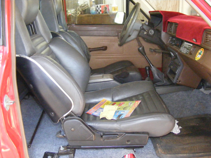

It's dirty but whatever..it's a truck.
The velour dash mat is from dash topper.
The carpet is home depot outdoor special (brown vinyl was ripped)
The seats are from a 1985 Celica Supra.
I put some inferior dynamat from Home Depot called Quick Roof (many hate this cause its cheaper, google yourself for 10page arguments about it).
http://www.homedepot.com/h_d1/N-5yc1...1#.UKHuu-Oe-C8
1 roll = 1.5 doors
5 rolls = both doors and entire floor
Biggest difference was the doors. They close with a more satisfying 'thunk' and are less tinny.
I did the entire floors but didn't really notice much of a difference since wind noise is louder anyways. I guess there are less rattles?... If I had to do the floor again, I would of just bedlined it and lived with it IMO.

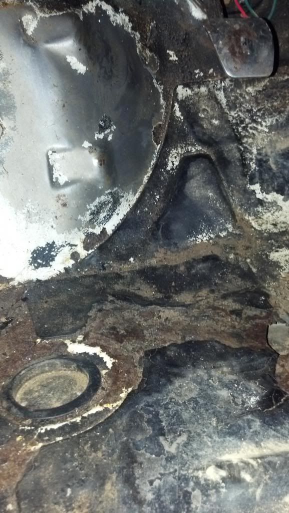

How bad do you guys think this cancer is? The floor isnt soft here, just a hole.

It is close to a body mount..you are gonna want to fix it..
