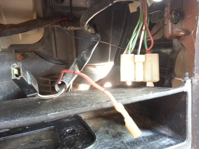

Size:  272.2 KB My colors are very different. I have red white...and the rest green.
Along with those other 2 connectors. Whatever they are.

Very confused. All of the diagrams I find mention a gray, brown, yellows....I have none of those. Does my pic make sense?

I'm guessing the 4 green on the left of the main connector are speaker wires. The white in the middle is my ground? Red on the right is my constant battery? Green wire on the right is my ACC? Really weird colors, don't match up to anything I've seen.

Solved the problem. Original owner had popped the ACC wire out of the trucks harness and used it to wire up a CB radio 20 something years ago. So the ACC wire wasn't in my harness. Reason for having no juice. Thanks for all the replys!
