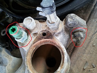

ok i been lookin from diffrent forms and findin people askin what the green one goes too but no one ever give a flat answer but i want to know what does the the 2 plugs go to that are circle in red thanks

Were either hooked up before you pulled the manifold? I think they're both temp sensors. One of them (the one on the righi think) goes to your gauge in the dash and the other is for your choke on the stock carb. Not sure though. Been a LONG TIME since I've had those. Search for the fsm for your year on this site and it should say.

yes both were hooked up
i think the temp sensor was on the right but not sure and ant sure what the other one is
