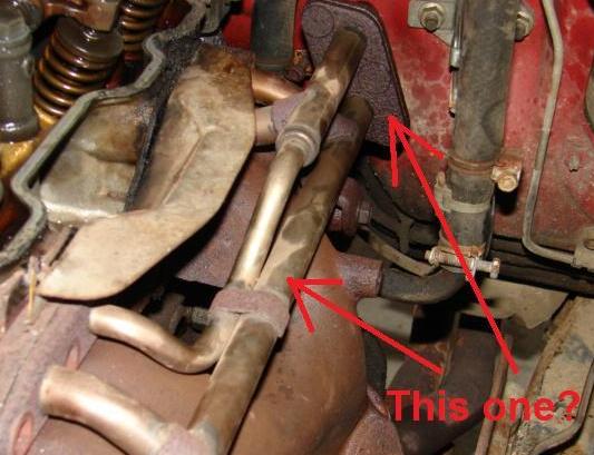

Originally Posted by razed
if you get the PAIR manifold separated from the pipe (two nuts and it comes apart) that wraps around the back of the head, the exhaust manifold will kindly slide to the side giving you plenty more room to get the head off the block.
We're talking about the one below? It's got 3 nuts, seems like that exhaust manifold would move more to the driver's side with it out of the way.
Hey razed (or anyone else), judging by the below pic, what does it mean that mine has 3 bolts instead of 2? with 2 tubes... (tubes to EGR, not exhaust)
I can see here https://www.yotatech.com/forums/f115.../#post51574012 that this other one has what you were referring to, with one tube.
