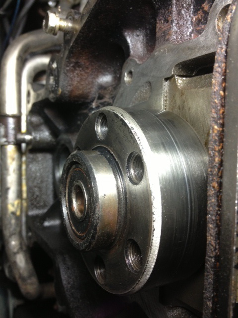

Doing the same job right now on my 93 22re. The engine rebuilder had installed a speedi sleeve. The seal was wearing unevenly on the sleeve and leaked all over. Not doing the sleeve this time. Im going to try to push a new seal a little farther into the housing, and get past the groove on the crank for a clean contact.

If it's pooling on TOP of the bellhousing, and the rear main is in teh middle of the bellhousing, how would it be the rear main? Maybe I read wrong
If you're doing it, recommend:
- Clutch/throwout bearing/pilot bearing
- slave (which you're doing)
- rear main
- check crankshaft - may need a new sleeve like 171 mentioned - a burred crank and tear up a seal and leak quick
- resurface/replace flywheel and bolts (I kept mine but they were $8 each at the dealer...crossing fingers)
- You may want to drop the oil pan while you're at it and clean/reseal with FIPG from the dealer
Good luck!!

I also don't think it's the rear main...
Since you just did your VC, I bet you somehow did not seat the rear main half moon seal right.
Reach around to the back of the head and see if there is any oil, I bet you will find some. I had the same thing happen to me once when I replaced the vlave cover when adjusting the valves. Did not tighten the VC bolts enough and it cause the half moon to leak. I just had to tighten the bolts on the VC more and it solved the problem...
