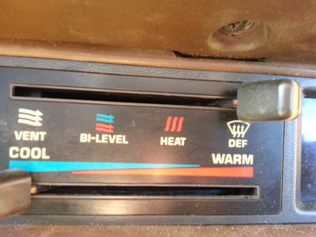

OK been cleaning ducts out and blower motor out for a few days. Found some things I need to fix like my (heat, vent, bi-lvel..etc) lever. Cable is to flimsey. Anyway my question is what are the functions of these 4 settings? Like when I have it switched to each setting...where should I feel air...and where shouldn't I feel it?

Pic of panel

Front vents, both the front vents and the lower vent above the transmission hump, the lower vent, and the top vents that blow on the windshield.
