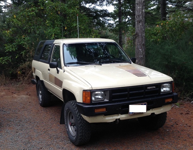

Here in the PNW these things go for outrageous $$$. I had two people try to offer me $$$ to buy in the 6000 range already. Interior perfect, body excellent, No rust, just high mileage...And now the result this issue. All machines need some love time to time :0 Its time...
