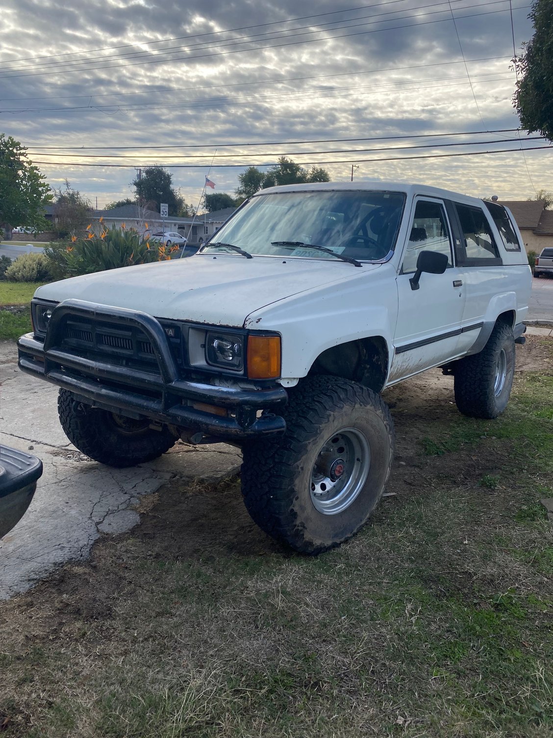

So to start yall off this is my 85 4runner i bought 2 years ago with the help of my parents eventually we did engine maintenance, runs good now, radio and alarm, next will be interior but after interior I want to dig into suspension I am about to be 17 and will be getting a job so I wanna start getting opinions and where I should go with the build because I don’t wanna do tons I wanna stay with toyota axles and I also don’t know what shocks to run etc. So 84-85 guys let me hear your opinions!

that truck looks straight and clean, appears to be a real keeper... watch out for leaks in the upper windshield area, it'll run down inside the windshield pillars and rust out from the inside, which is very difficult to repair... truck cover is a good idea, also because the sun will rot out the interior plastics and rubber, much of which is unavailable these days... even simple things, like that rubber seal that goes around the fold-down door in back, has been oos for a long time.
you'll eventually have to do maintenance on the solid front axle, which can be a pain in the neck, but if you are going to go 4-wheeling it's a good time to think about upgrades... locker, chromoly axles, etc... similar for the rear axle, what people do there is first put a v-6 rear end in there, if it doesn't already have that pumpkin in it: https://www.lceperformance.com/category-s/23291.htm
so you'd be upgrading the better rear axle.
hopefully it's the 22re? not carbed? if you looking for parts, pick up a backup 53ex igniter, they have been oos for a while now and if it dies the truck will not run... i carry it with me in the truck, because mine died and left me stranded.

yeah as most 4runners like mine have plastics like the dash, seatbelt plastics and some of the hardtop covers are cracked or have broken tabs I do look forward to eventually replacing them if I ever find them but as to the point of the igniter mine had a problem with the starter which I’ve replaced and alternator works and has a brand new battery it hasn’t gave me no problems dying yet. As far as leaks nothing has leaked on me yet but I do look forward to replacing the trim on the windshield. But as far as the suspension I took her wheeling and she performed above my expectations so I know I already want to start digging into replacing front axle parts and for rear end I want to go for a comfortable ride but also be able to wheel and have fun what’re your recommendations on shock setup?
