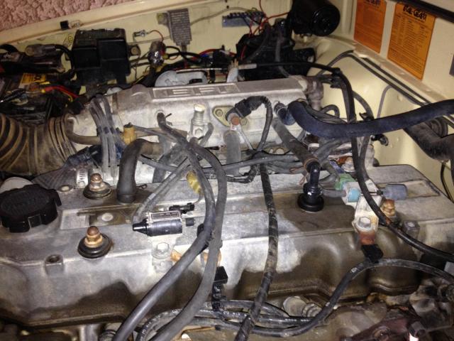

so i just took my 85 EFI in for a smog check and the smog tech failed the visual inspection saying that I tampered with my PCV hose alignments, He also I failed my timing check, saying i'm at 12 Degrees before top dead center.

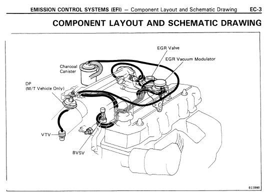

here's the hose he pointed to saying " you can have this blowing oil into the intake!" as far as i can tell that is the exact hose the FSM says to have and its run properly, or am i missing something.

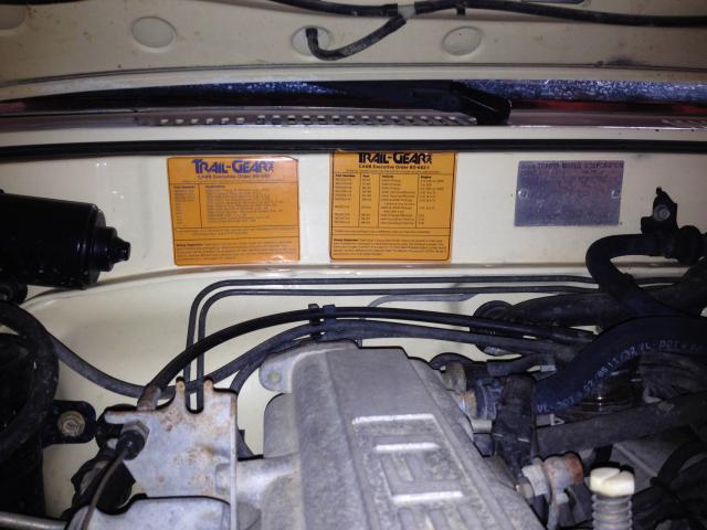

the last and final thing that i'm not so happy about is he said my trail gear smog exempt stickers for the header and intake were fakes and don't count. and even if they were real, they don't mean anything you cant add a header or intake.
am I missing something here? does he have legit statements?

Bring a copy of the vacuum wiring diagram that you posted up with you to your next smog. That should solve the vacuum issues. As for the header and intake, all smog inspectors use a database to look up the CARB EO number anyways so he's really a dumbass for just blatantly saying that.
