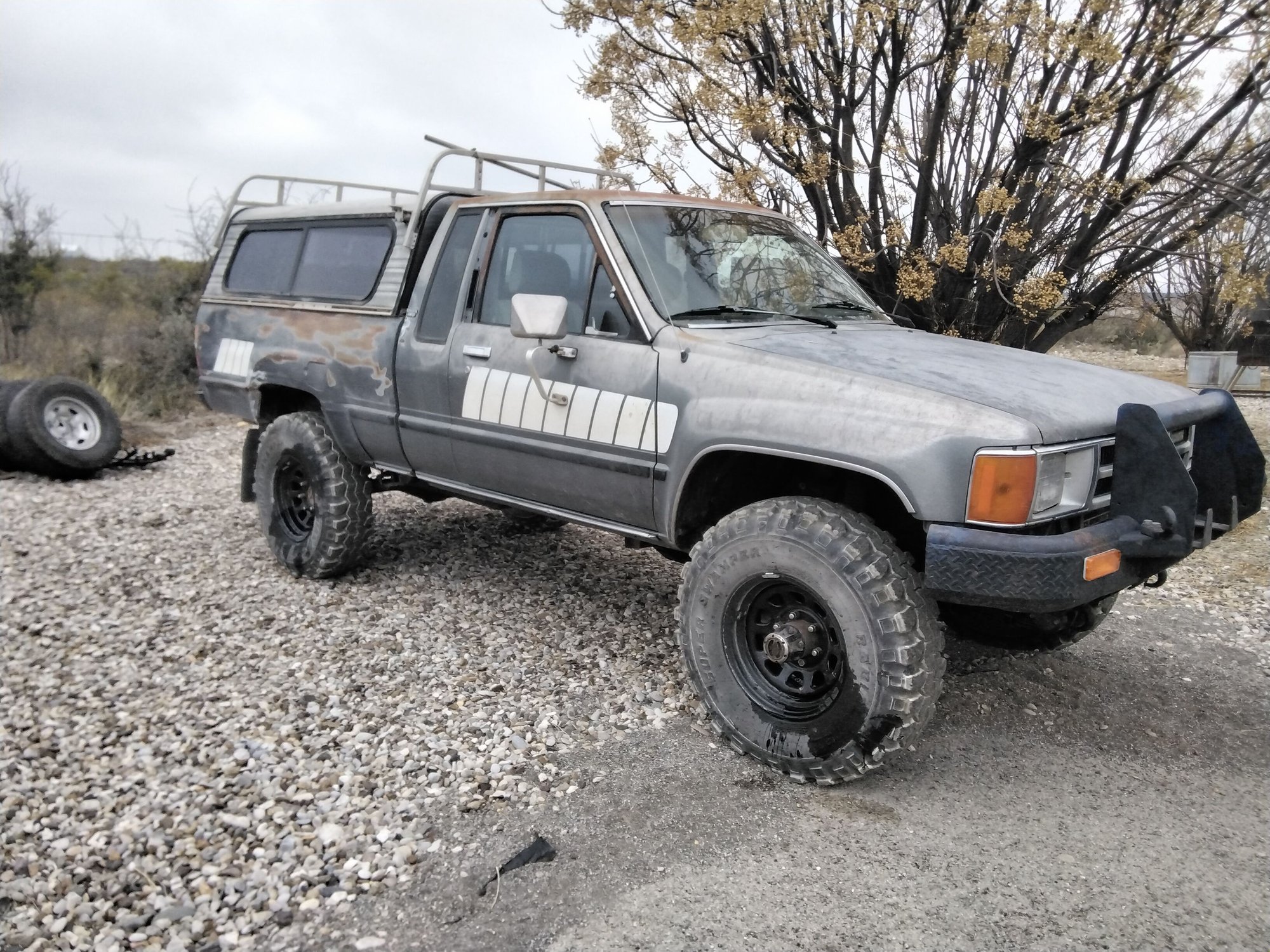

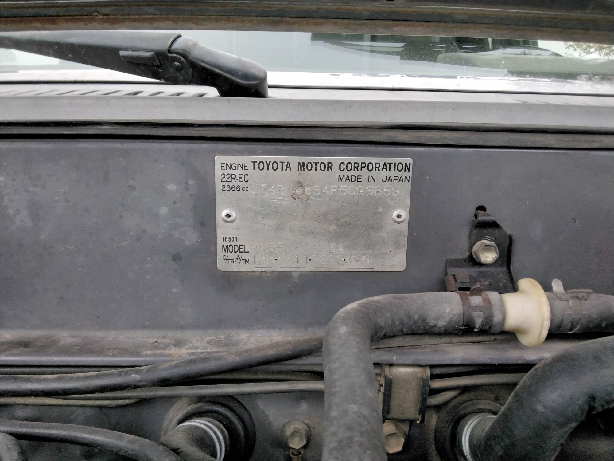

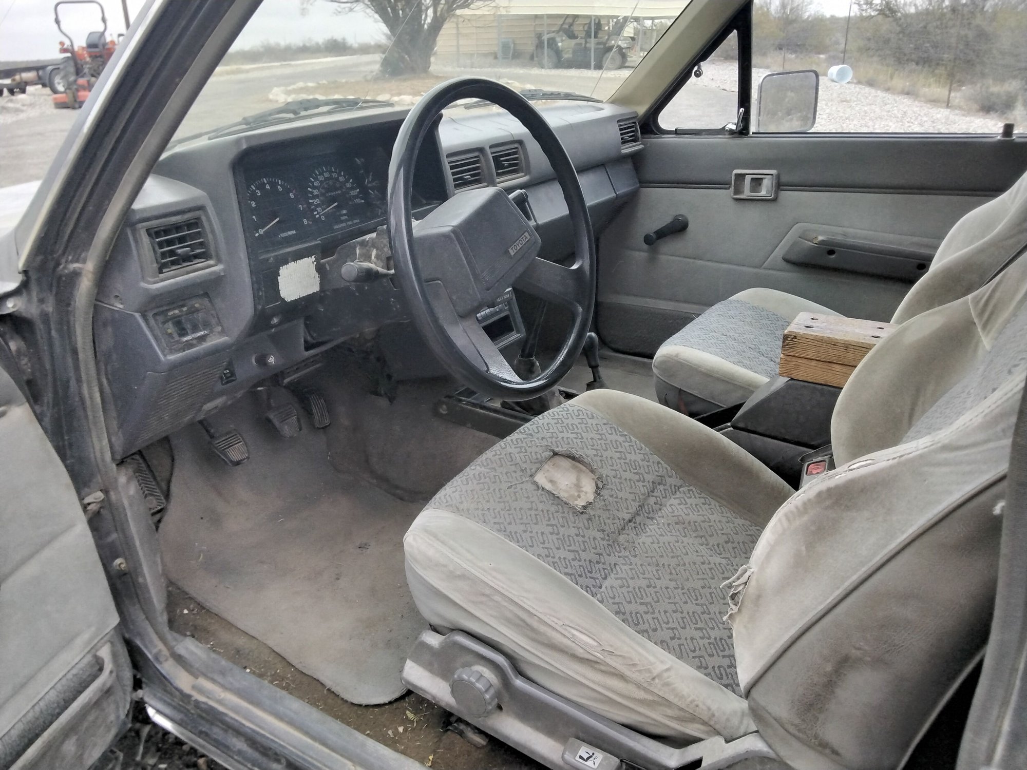

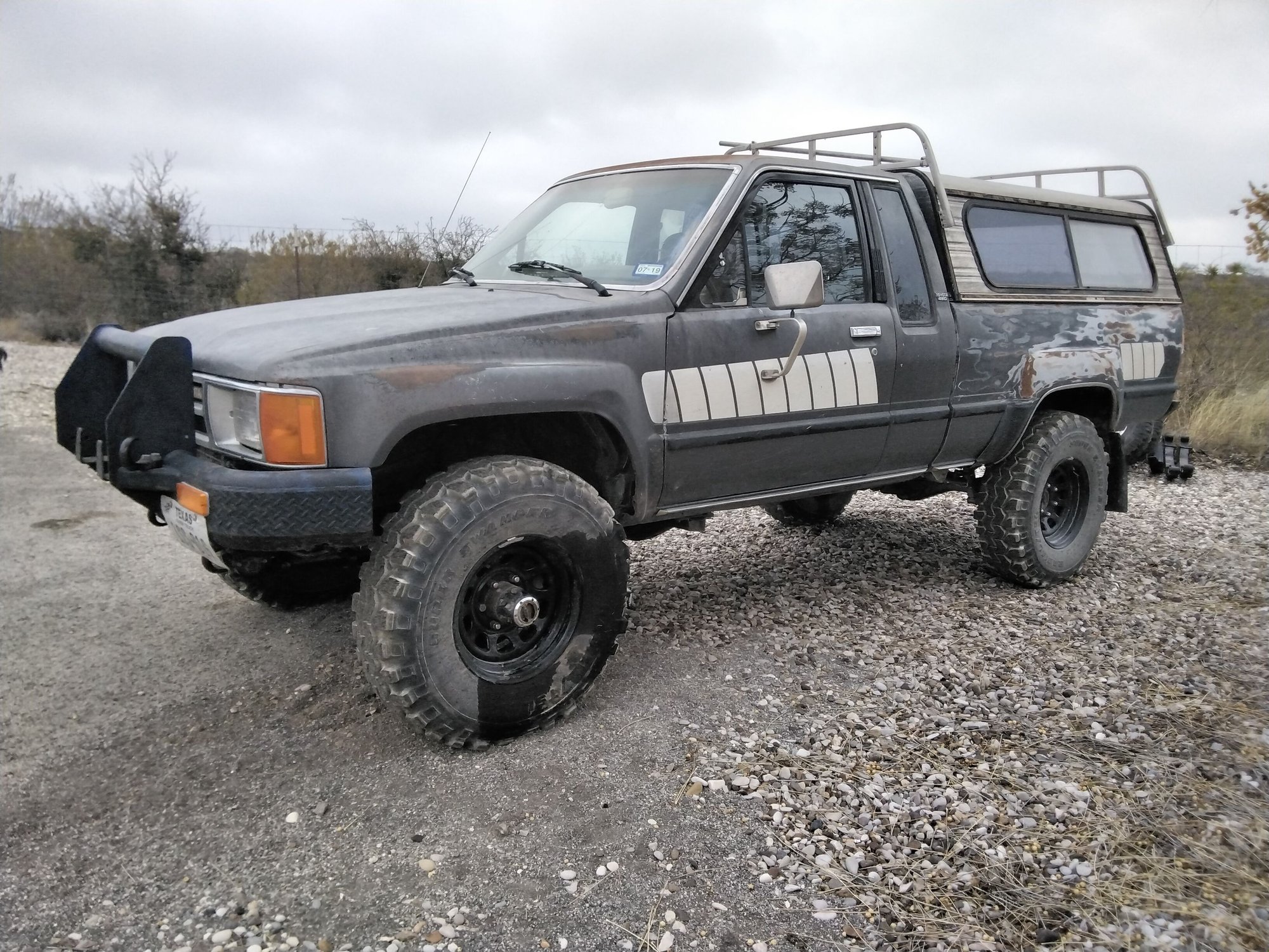

Yes, they exist! 85 SR5, AC, 5spd, PS, Solid Axle.

Agreed. I've only seen a couple others speced the same over the years. This is actually my second time owning this truck and I won't let it go again!
