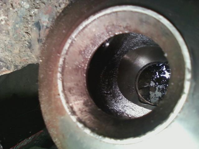

This it pretty pitted and it looks like in the FSM that is can be removed and replaced although, I'm not sure. It looks like it's all one part.
Attached Thumbnails can this be removed/replaced?-downsize.jpg

What is it?

Sorry, but cant tell what part it is, if you give us a better explanation of it then we will be glad to help

looks like the bearing race in the knuckle ball on a solid front axle. yes it can be removed and replaced.
get a knuckle service kit with bearings from trail gear. second or third item down on this page ---> http://trail-gear.com/knuckle-service.html
install instructions on this page. a picture showing the race removal is about 2/3 down the page http://www.4x4wire.com/toyota/mainte...nd/solid_axle/
any rust or pitting on the knuckle ball itselff can be lightly sanded to remove it.

That would be the trunnion bearing.

Trunion bearing race. Replace and match with the bearing.
One on top and bottom. Knock the top one out from the bottom and vice versa. Clean up the backside and you will see 2 little indentions in the knuckle ball to expose the backside of the race where you can hammer it out with a punch.
You have come this far so you might as well rebuild the whole axle.

I bought the whole hub rebuild kit from you, I haven't had a chance to thoroughly look through it (i've been painting stuff). Does the race come with the kit?

never mind. I just took a look at the kit more carefully and there is the trunion bearing race. Thanks.

Yep, all bearings typically come with their own race. Let me know if you need something else when you start rebuilding. I did a whole front axle in about 3 hours last weekend.
