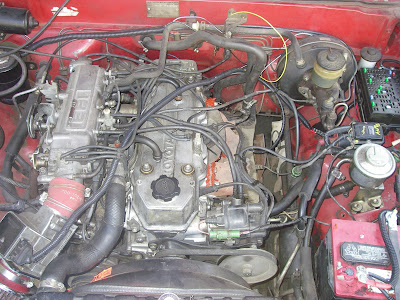

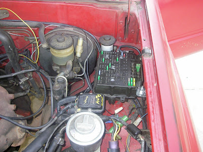

I've seen a lot of posts with people talking about installing auxilary fuse bocks, mostly from Painless. I just wanted to share how I just installed an auxiliary fuse block will nearly unlimited potential and spent less than $30.

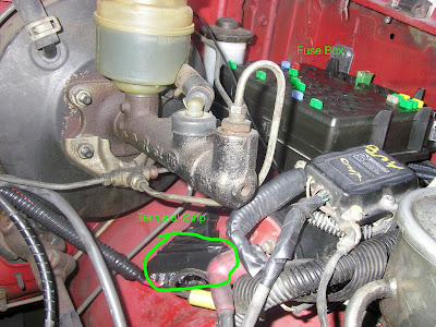

I picked up a fuse block (out of a 2001 Chevy Silverado), wired it to a terminal strip.
I found this fuse block on ebay for about $15 shipped, the terminal strip was about $8.
I used a continuity tester to map the block in order to properly wire it.
Currently, I've only made use of 10 of the 40+ available circuits and haven't even started adding relays yet (it has room for about 11 relays).
You can see below how it's set up under the hood.. though theoretically you could locate it anywhere. This particular block is a little large, but once I moved the coil it fit snuggly in the corner.
