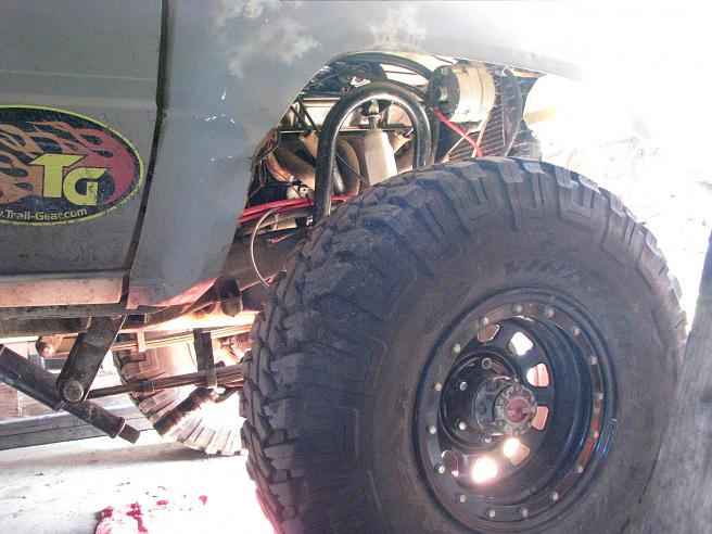

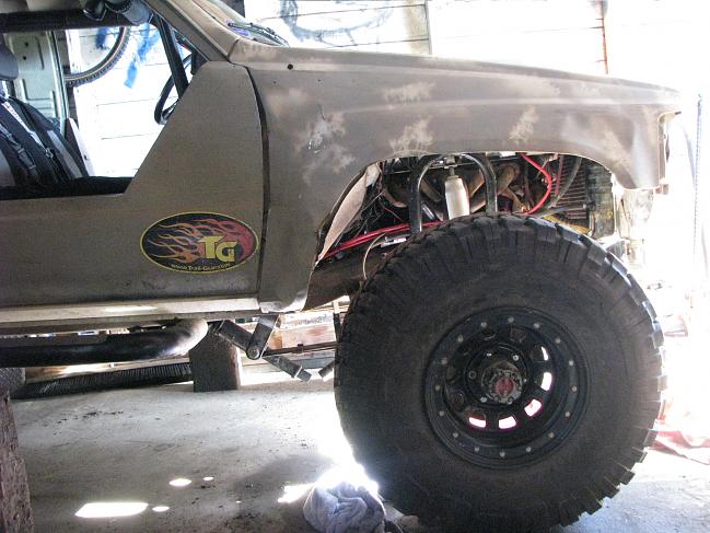

I have never been very happy with the way my truck flexs. The kid i bought it from installed a pro comp lift that is rock hard. It might as well be lifted with cinder blocks.
Anyways i had some first gen 2wd rears laying around.
Question: are these too soft to handle the weight of the sbc???
I know RUF are a popular swap/ but is 2wd ok?
here are some pictures of the new stance with 2wd rears.
i love shackle angle now!!!
still need new u-bolts, and a flat pitman arm, then i wanna try these babies out.
Plus i think i moved the axle forward an inch or so, and she doesn't look so tippy anymore!!!!!
Attached Thumbnails Another 4runner redo!!-img_0027.jpg   Another 4runner redo!!-img_0025.jpg

anybody have any input. 2wd rears too soft???

im guessin sbc= shortblock chevy? i would say theyll be to soft. but thats just me. id say theyll flex like no other though haha

yes i agree with your flexible answer. I was kinda hoping that somebody running RUF's would answer this question!!!!
i hope they are VERY flexy.
small block chevy yes!!!!
will i have too much negative travel???
i will keep you posted.
until then bring on the advice!!

looks good, you may want to add one more leaf just to make the pack last longer. but youw ill love these springs, yes they are super soft and flex great.

thank you for the input 85toy. the truck i pulled them off of had 270 thow on the tach. you think they will settle more than they aready have??
anybody have a flat ifs pitman arm for sale in washington 360????
i hope when i remove the rear blocks she'll sit level until i
find a set of rears??
i think im gunna get some perches and try out the 63's!!!
how much up travel should i expect? im thinkin 2 inches or so to the bumpstops!!!!
does that sound about right?

i got the truck out and flip around start removing the rear blocks.
slow n steady
