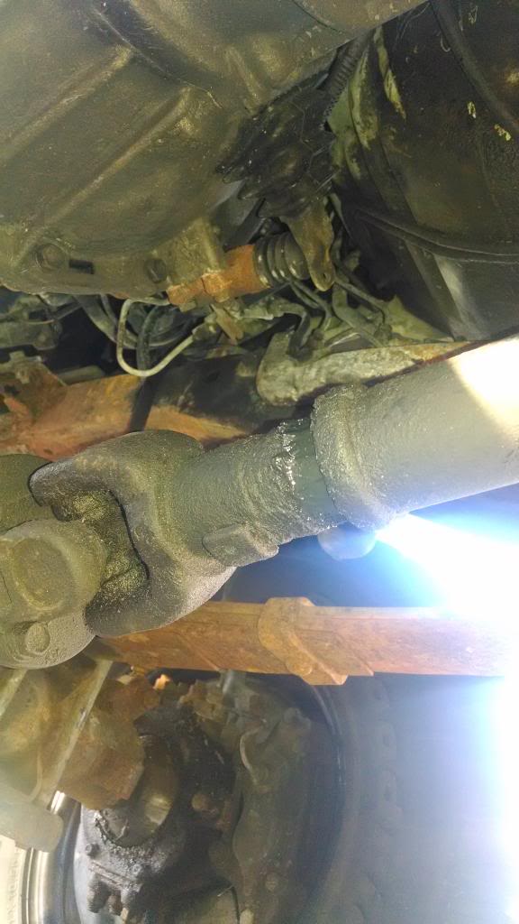

Thanks Highlux. I'd like to dig into and replace as much as I can while the trans is out. On a sidenote, could the trans issues have compromised or damaged my driveshafts and components or vice-versa. A quick inspection today revealed this.
Rear
Size:  90.0 KB some kind of fresh grease/fluid can be seen sourounding output into shaft.

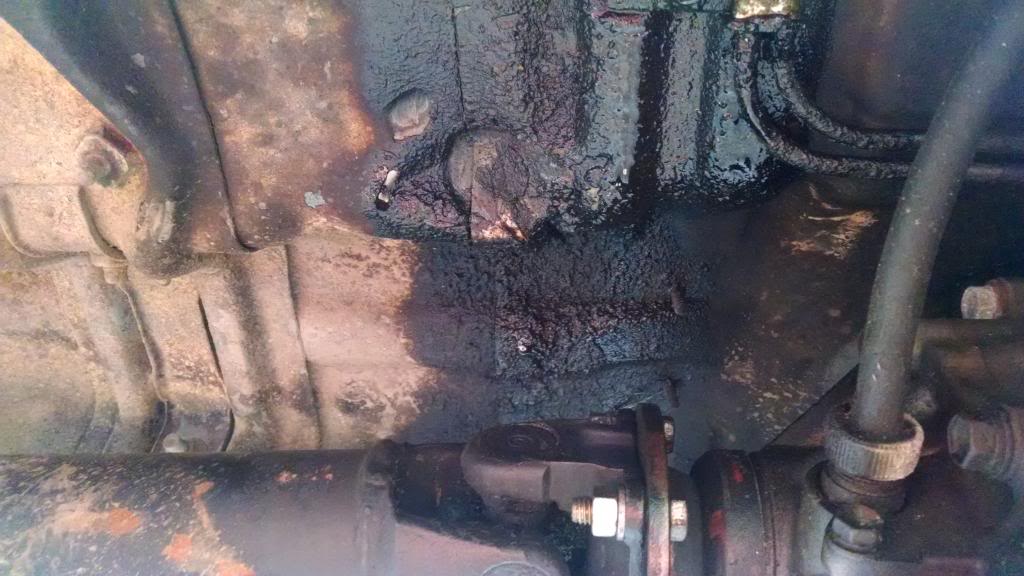

Front
Size:  70.4 KB yoke seems extended with fresh grease visible. Never noticed this before so I don't know if its normal, guessing its not.

Not sure on the shafts....check the joints well after you pull the trans...you will have them out for that.
I imagine that trans is pretty toasted inside...if there is even one gear toasted...you will crap when you see what hard parts like gears cost.
I tend to think the good used trans in the way to go....unless you have a press and bearing separators and pullers and micrometers...etc. And skill.
