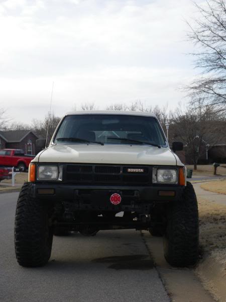

Sorry it's been so long since I've posted but I've been dealing with engine issue's. Anyway to answer some of your questions first off I cut the fenders with my 4" cutting wheel on my grinder. Second I moved the axle forward by cutting off the old spring hangers up front and welding new one's on further up (built a brace for that). Third I have already re-geared to 4.88's with detroits front and rear and plan to put a 4.7 in the t-case soon.

Yeah the secret to not rubbing with no lift or very little lift is be prepared to tub the firewall and cut anything and everything you rub on.

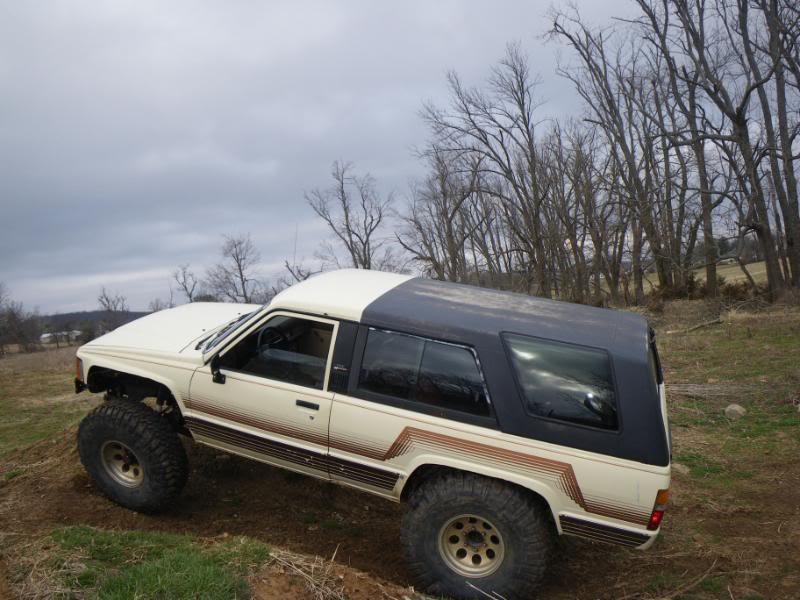

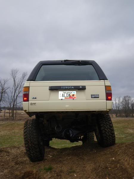

I finally got it running good so I took it out for some pics and I'll post more pics as I start the mods.
