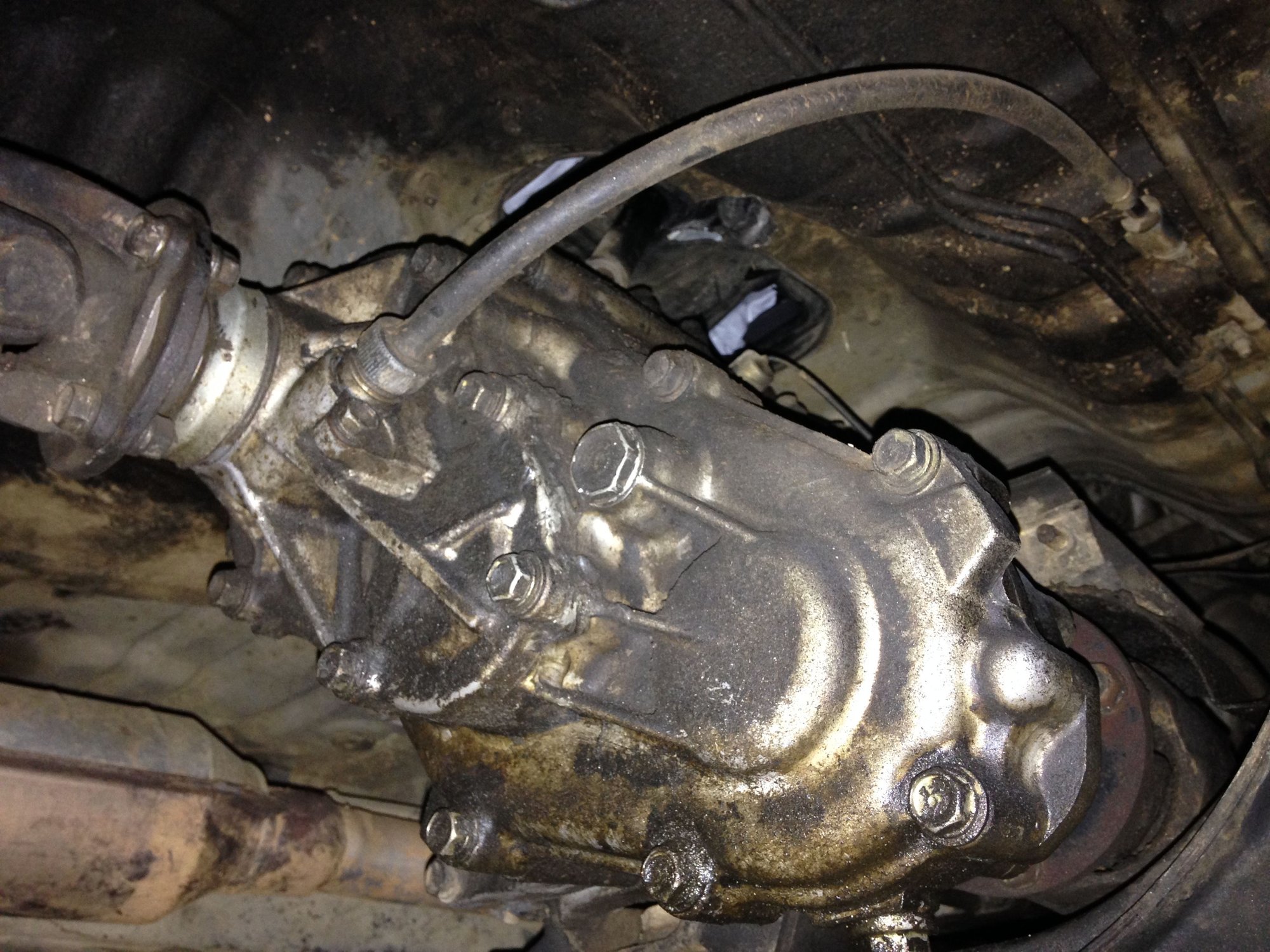

Here is a pic of the t-case with the speedo cable coming out. Probably a separate issue, but it is definitely leaking from somewhere. Any ideas?

Mine does not work either but I just unscrewed the serrated ring with a pair of pilers and undid it by hand from there. once that was disconnected the cable end just pulled out of sensor(which is bad on mine). the cable part of it is just a square flex drive. I'll be watching thread to see if you geta fix or need a sensor. I haven't found a new sensor yet so...

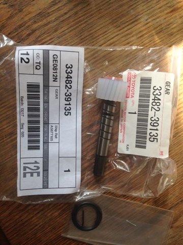

Replaced the gear and it works now.

glad you got a fix where did you get the gear? also can you get one that compensates for larger tires?
