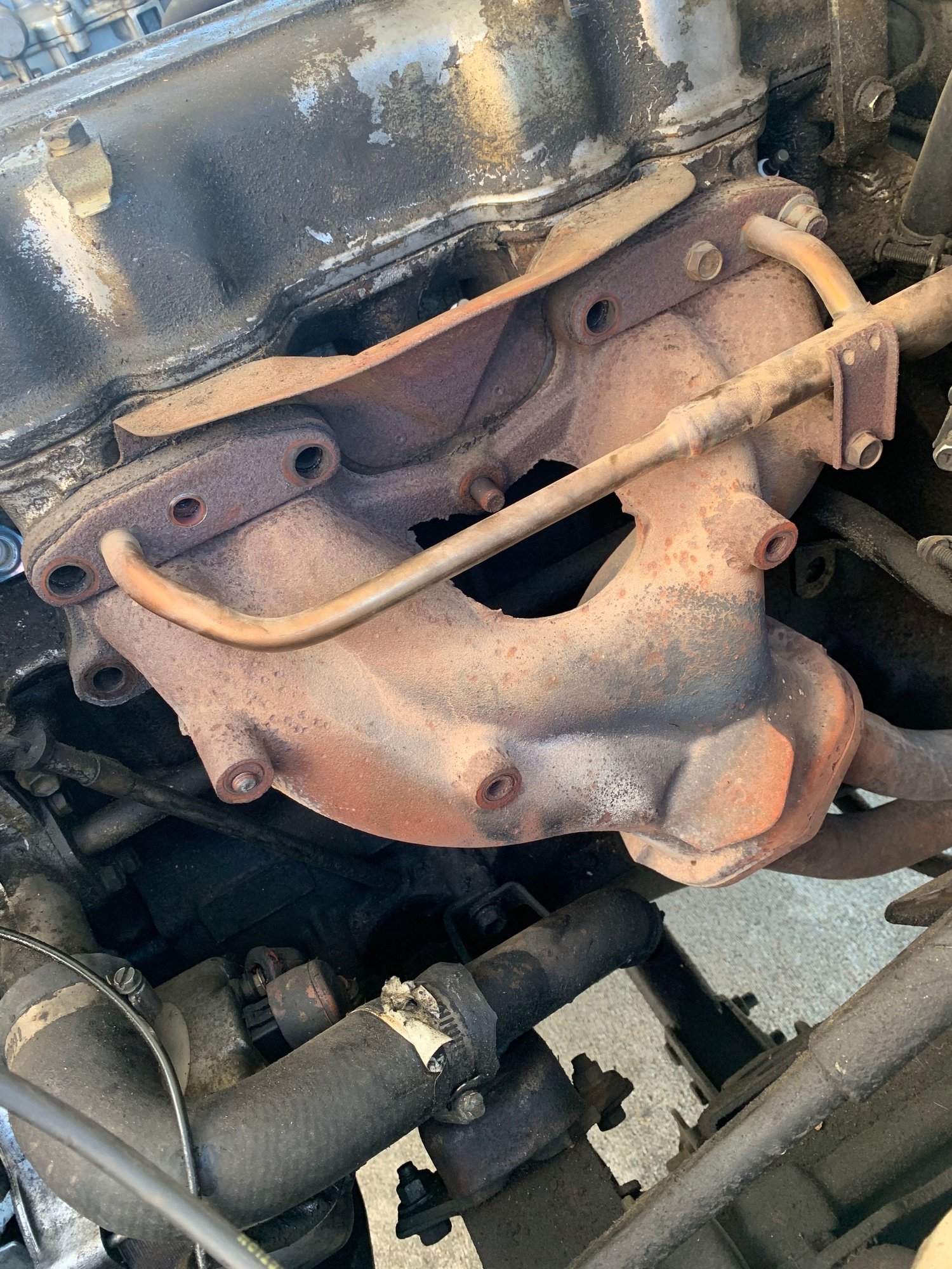

As for the exhaust manifold, I pulled off the shielding to get a better look. I wasn't able to find any holes but the surface has pockmarks and is otherwise in rough shape compared to the other components around it. Next step is ordering a replacement manifold and gasket.

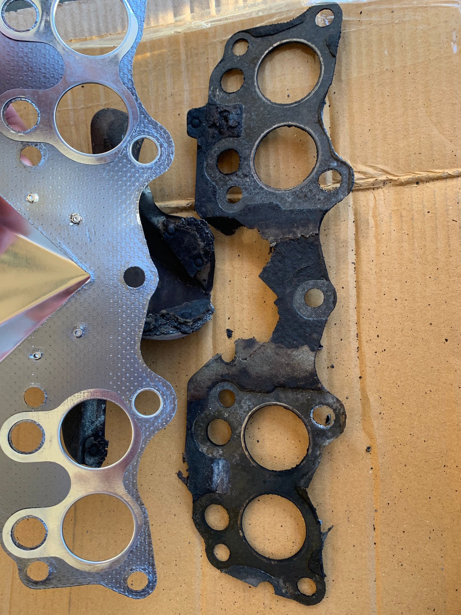

The exhaust manifold gasket was in pretty rough shape and came apart while I was taking off the exhaust manifold. I took a comparison picture between the new gasket and the old in an attempt to isolate if the failure occurred with the gasket.

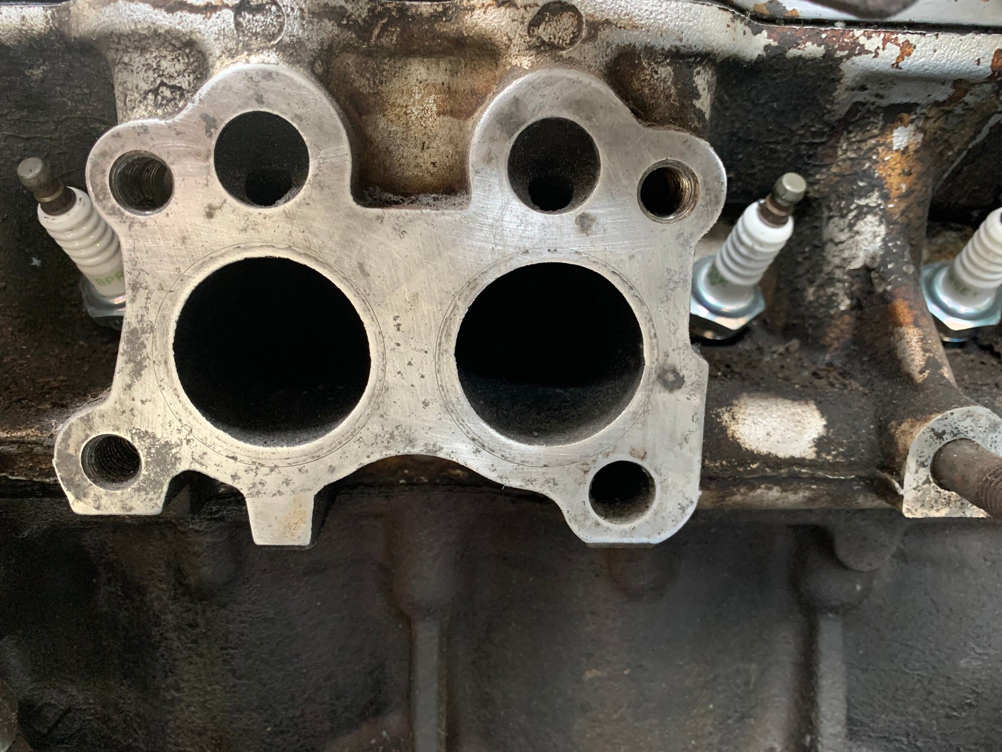

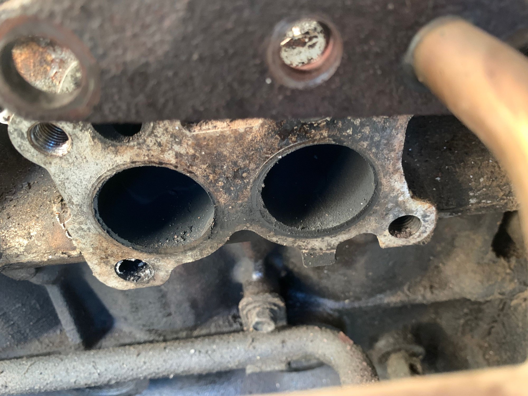

From this picture there is a bit of difference in the wearing near the 3rd and 4th cylinders compared to the 1st and 2nd. I do not believe the tear between the 3rd and 4th was related to the removal. Taking a look at the engine side of the 3rd and 4th cylinder it would seem that the gasket had failed leading to these two cylinders to be exposed to each other.
Compared to the other two:
At this time I believe this was the source of the exhaust leak and the noise.
I took a little bit of time to remove some of the carbon build up around the areas that the manifold made difficult to get to. I then took some fine grit sand paper to remove the parts of the old gasket that remained stuck to the engine. I plan to go over it again before I put on the new manifold but here is the first pass:

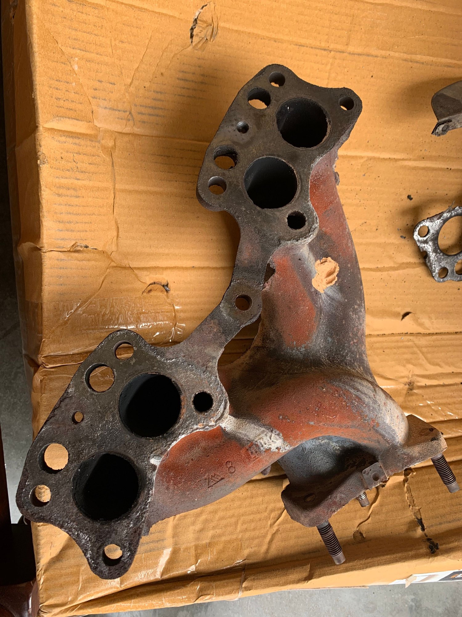

Also here is a bonus picture of the old manifold from the inner side. The bit that looks like someone stuck gum to it is some sort of insect lair that turned to dust when I poked it.

You're doing a lot of good work here. Just try to get the mating surfaces on the head as clean & flat as possible without going too crazy over it. The metal gasket is a crush gasket & will "take up" any small imperfections on the mating surfaces of both the head & the manifold. I just like to give them all the help I can while I have access to those surfaces, especially those on the head. I usually use a steel wire cup brush on a drill to get all the old stuck-on gasket remains off, then 220 grit sandpaper on a sanding block. I just do enough so that the surface is bright & clean. It comes out pretty smooth.
I also vacuum out all available ports when I'm done sanding.
I've also been known to take a metal ruler to the manifold's mating surfaces to check for any warp-age. It would be interesting to know if you can see any warp on the old manifold near where your leak was.
