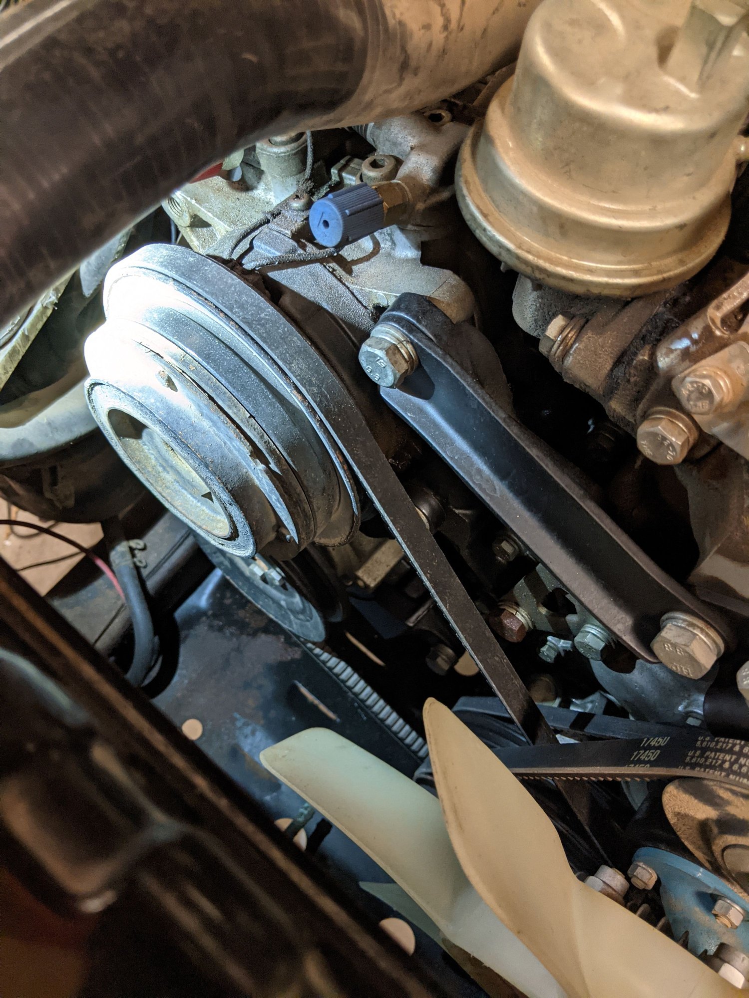

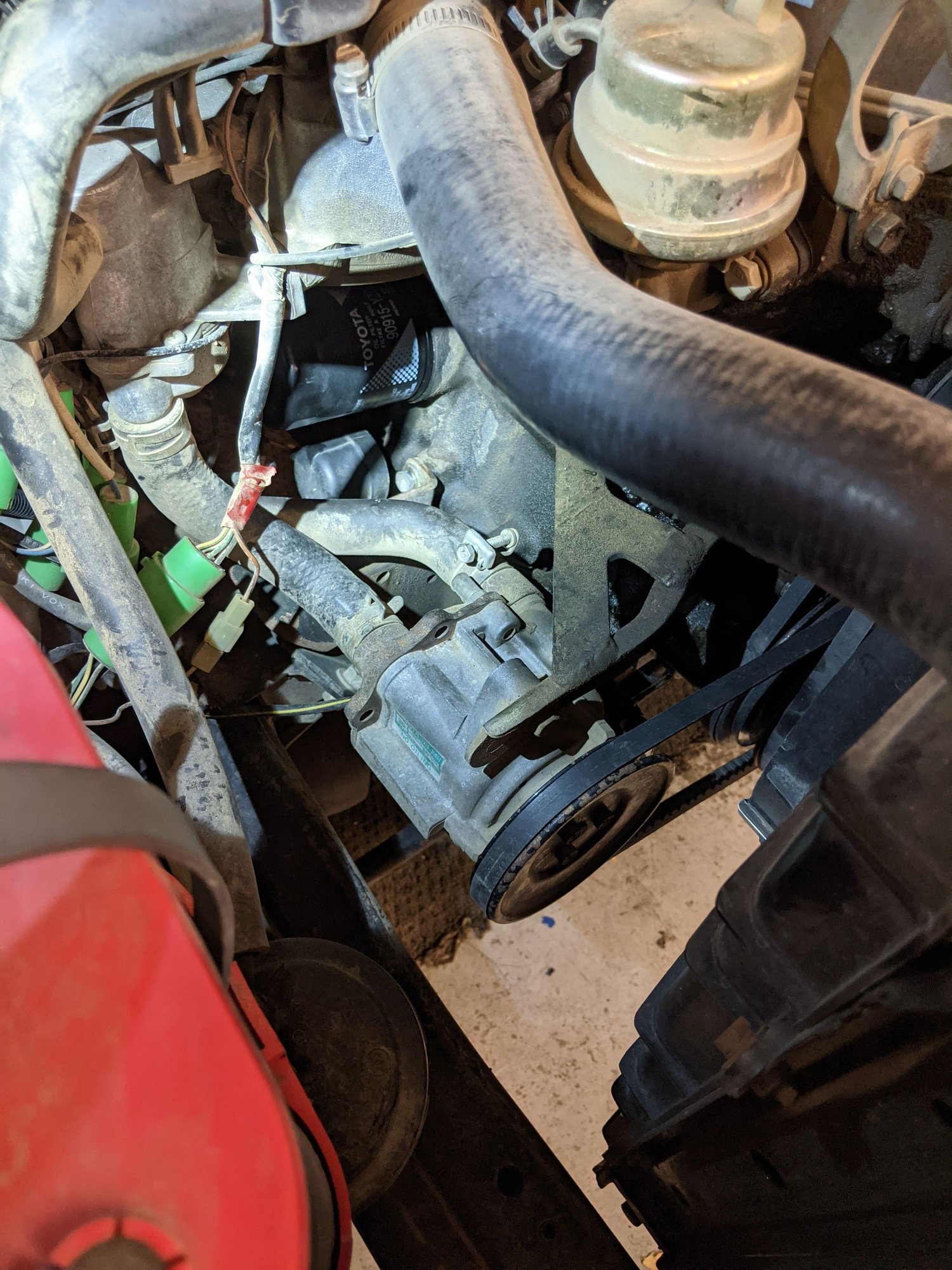

Old Jan 16, 2024 | 02:18 PM
FourEyes's Avatar
5 Year Member
Joined: Jun 2016
Posts: 94
Likes: 16
From: Oakland, CA
Mechkw,
Here are those pictures. Sorry they aren't the best, it's difficult to get a good angle on the A/C + smog pump as there's not much room:
1983 with factory A/C and smog pump:
1984 with smog pump only but located in the same location as the 83.
The bracket for the smog pump is different when there is A/C vs no A/C
Hope that helps!
