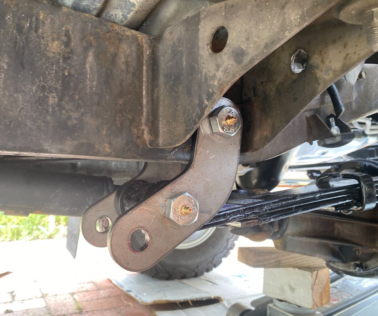

Beware! I am just finishing with my '85 and it's taken over two months. First set was stock no lift from LCE and they are junk. LCE screwed up by sourcing from a Texas truck supplier who drop shipped me a set out of Mexico. From day one they sat colapsed as bad as my 39 year old OEM's and the frame was on the shackles with maybe 1" bumpstop clearance. It took 3 weeks to resolve that mess with LCE and not so much as an apology. Another 5 weeks after ordering from Alcan. BTW, Alcans are factory spec, flat with about 2-1/2" bumpstop clearance and 1" shackle frame gap. The ride has greatly improved with the frame not riding on the shackle. FYI, I did not want the OEM rubber bushings and ended up with aftermarket urethane greaseable and pins and shackle bolts with zert fittings. Our trucks have zerts on the driveline and steering so no big deal doing the suspension at the same time. Also if you want to raise the front 1" or less do not use AllPro shackles, trust me it's another mess not worth explaining. Sky's Offroad boomerang shackles are the way and have them make to your length spec. I'm 4" hole to hole
and truck is level. Pictured are Sky's 5" which are too much and I re-drilled holes to 4". Still need to cut down the xtra length for looks.
