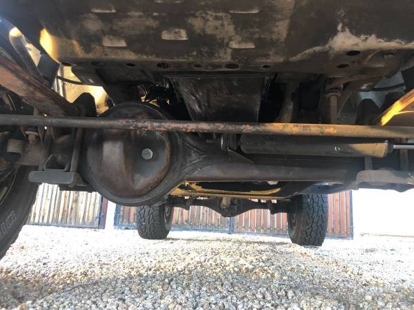

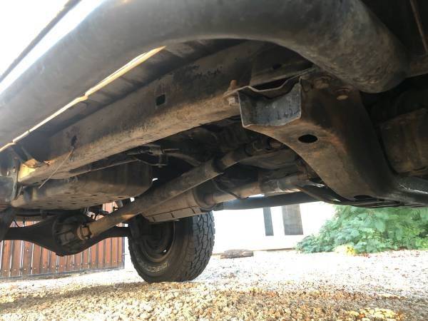

So several things...
Those black rub strips as far as I know were not a factory option, perhaps the dealership put them on, worse a PO. Point is I'd be careful of what's hiding under them, particularly on the box. If its covering the seam that's there you can count on at least some rust, desert or not! Now I've only owned mine 37 years so I may be wrong!
Frames are always suspect for rust.
Spray on bed liners is always a red flag for me, what's it hiding?
Its "normalish" for some grease leakage at the steering knuckles. Check the axle oil level and see if its full...usually there will be some of the knuckle grease blown into the diff that will turn it into a sort of silvery grey colour, assuming the POers did do regular maintenance.
What was resurfaced on the head, the valve seats or was it decked/plained/machined what ever you want to call it? If it was decked count on the cam timing to be retarded (the cam will be lagging behind the crank). It wouldn't be much maybe a degree, you may not even notice it but it will shift the power band upwards slightly.
There are some broken plastic bits which are all but impossible to source.
From what I see here $5k is a touch high. You'll maybe have to put another 3 to 5 into it to get it up to snuff. See what it'll take to licence it. I'd see if he'd take $4500 as is. That said, I'd buy it from what I see.

Some more observations:
1) If the engine overheated (note the new upper radiator hose), that might be a reason for the blown head gasket. Otherwise, these 22R engines are NOT known for blowing head gaskets.
2) In the photo of the dash, you can see that the steering column cover is missing. Interior parts are virtually impossible to find for these trucks, so they're expensive. If the interior is ratted out, figure on spending several thousand $$$ fixing it up.
3) Whoever installed the Weber carb did NOT de-smog the engine. If you live where vehicles must pass a smog inspection, the engine can't be de-smogged. Otherwise it's easy and a good thing to de-smog it.
4) 270,000 miles is a BUNCH of miles on any vehicle. If the truck didn't receive normal/routine maintenance, with receipts to match, that's yet another reason for your offer to be lower.
5) I really hate that rear bumper. Looks like it came off a Sherman tank or something.
6) I sold my '83 for $12K, which was about $500 less than I had spent on it. Get ready to spend some money. These trucks can hold their value depending on condition, condition, condition.
