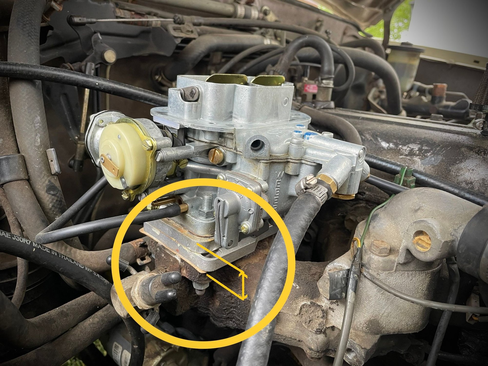

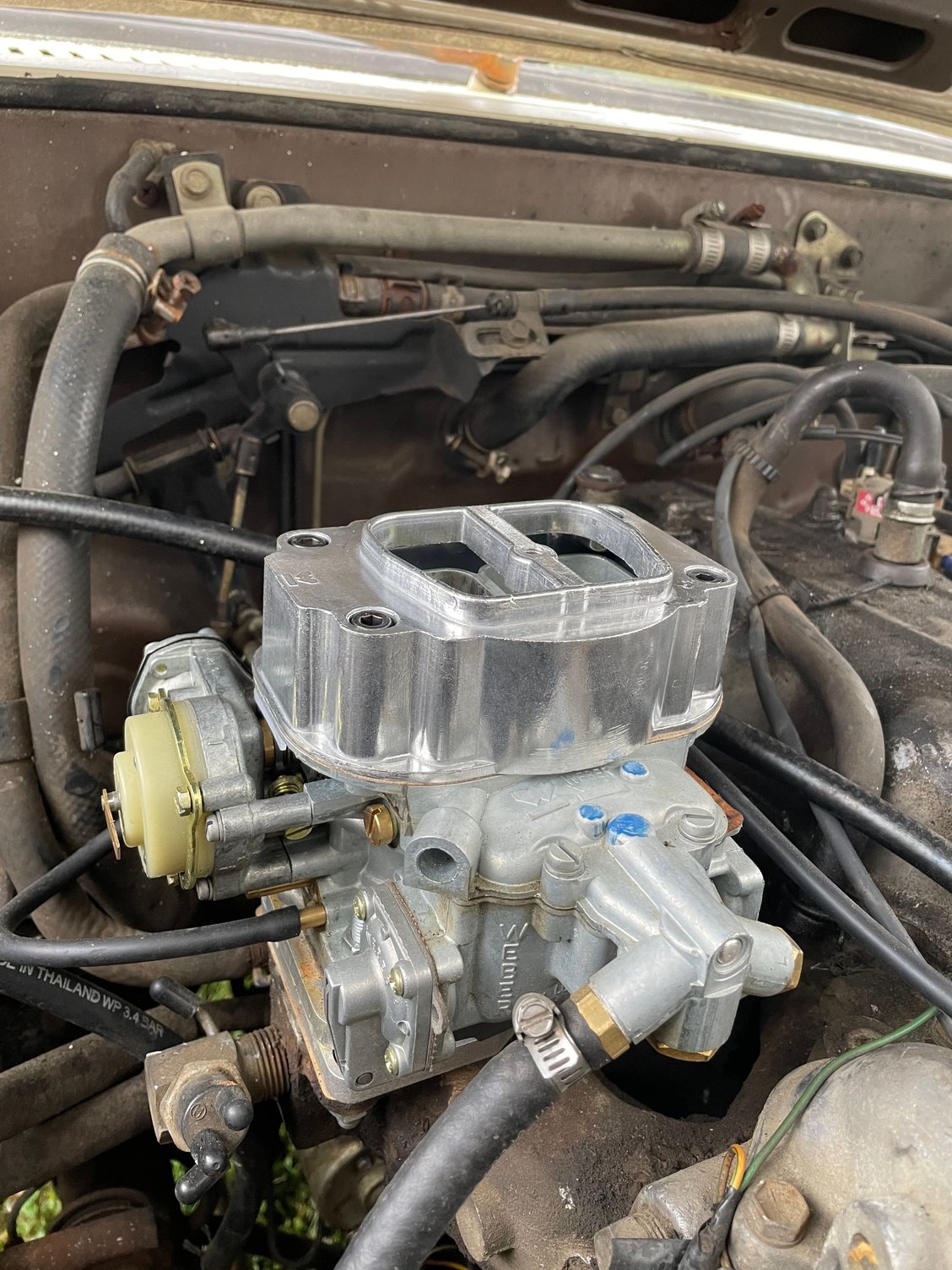

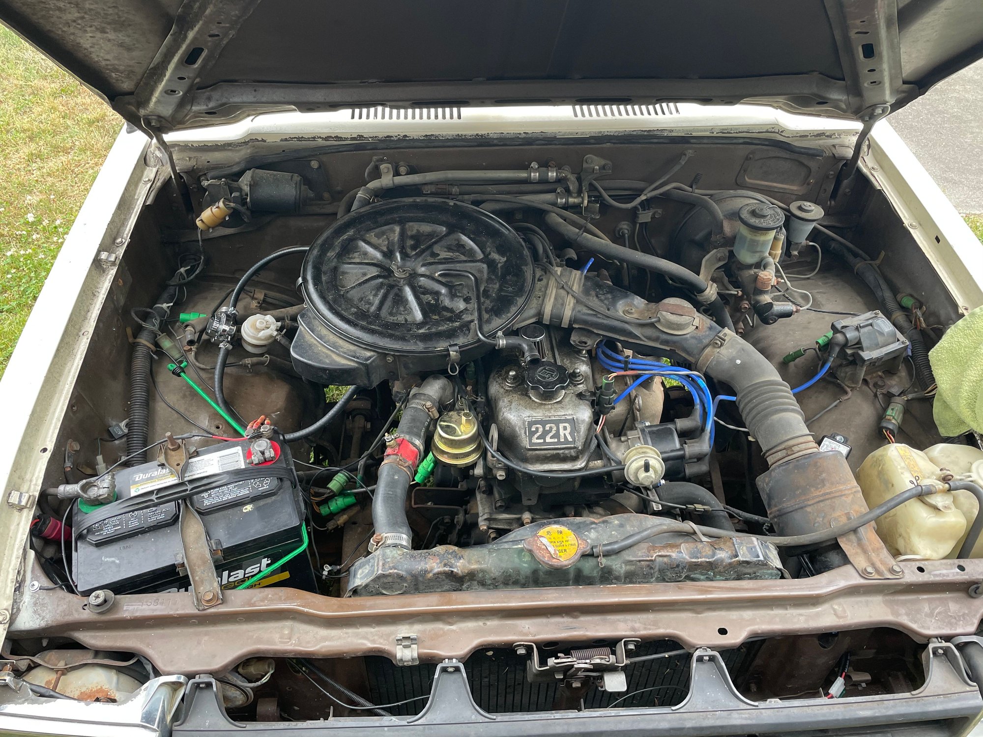

I bought a 1982 2wd long bed with a Weber 32/36 already installed. The stock carb and air cleaner were included. The truck runs great but I wanted to put the stock air cleaner on the Weber. I bought the adapter from Weber and the air cleaner fits the carb like it should but the intake adapter plates made the air cleaner base sit about an inch too high. Any solutions?
Air cleaner base sits too high
Intake adapter height
Stock air cleaner installed on Weber carb
Weber carb as installed with both intake and air cleaner adapters.

Take the stud out of the valve cover, go to your local hardware store with stud in hand. Buy a piece of all thread with the same thread pitch along with two nuts and washers that fit.
Put the all thread in the valve cover, put one nut and washer on at the height which your air cleaner wants to rest on the nut. Tighten the second nut and washer down on top. Voila!
You should also note that your carb is going to run richer than before with this air cleaner so you'll need to adjust your 'lean' screws, and possibly change idle jets.
