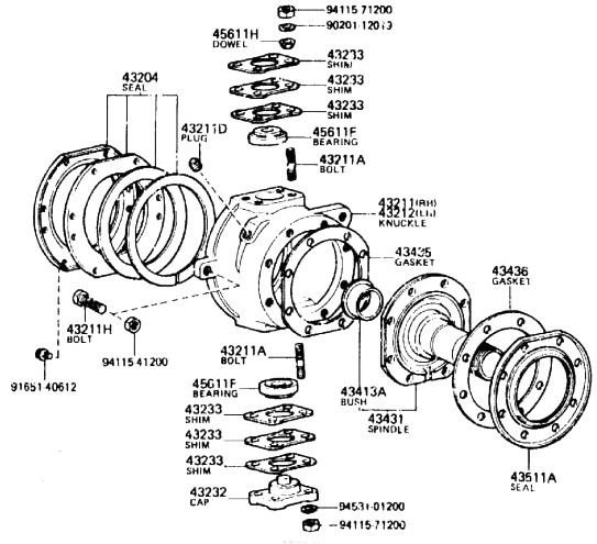

I'm trying to get my 83 pickup through VI and they just failed it for ball joints along with some other nitpicky BS. The truck has a solid front axle which is new to me and I can't see any ball joints. This is probably a stupid question but I've searched and can't seem to find any info. Does to this setup have ball joints? If not what wear can account for vertical wheel play in a solid front axle hub?

There are probably talking about #43232 in the picture. If they don't know a solid axle doesn't have ball joints, they shouldn't be inspecting cars.

no ball joints
what are your symptons? does it pull to left or right? Do you have death wobble?
do you mean tie rod ends?
up and down wheel play could be wheel bearings, trunnion bearings etc
probably time to rebuild the front end
