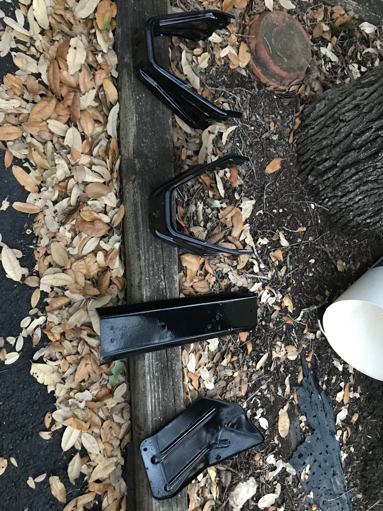

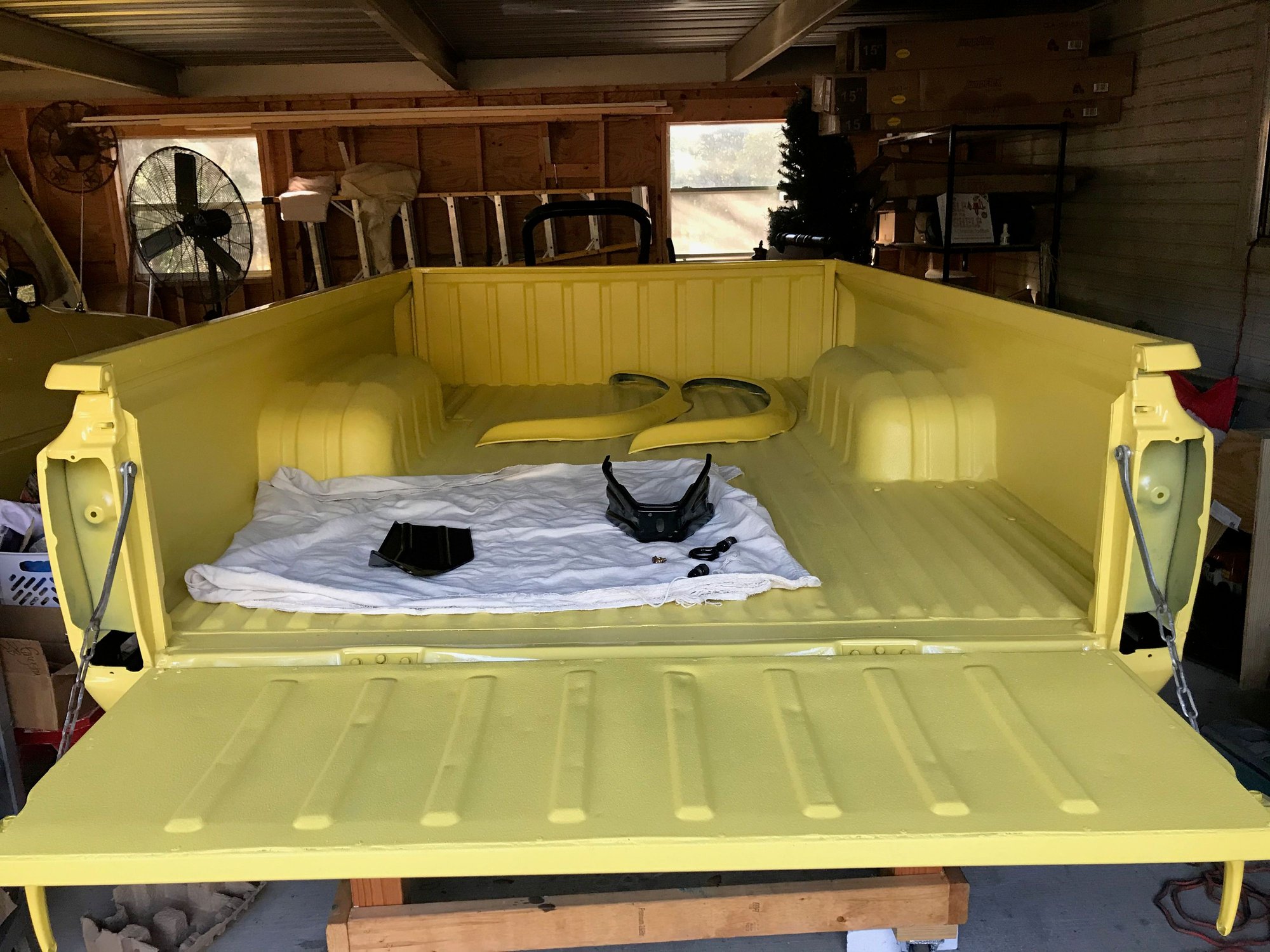

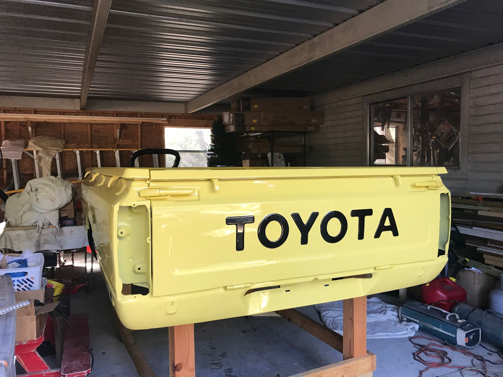

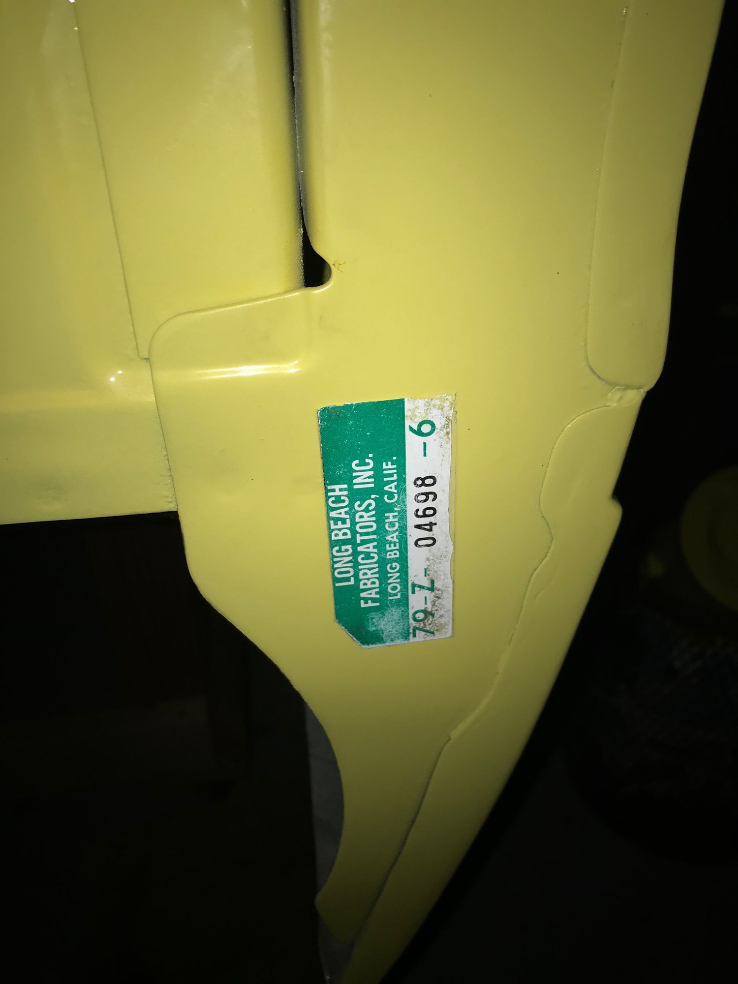

Got my bed and back bumper back from painter - he did an outstanding job and rhino lined the bed in the same yellow but removed a few items under the bed - pictured - I know where the front supports go and believe one piece goes to protect gas filler neck but the rectangular piece goes somewhere above exhaust (?) i think. I normally take pics of everything but do not have the under pics of bed. Anyone have underside bed pics I can refer to? Seeking on the web... see pics - taken at dusk so looks tailgate looks lousy - color is perfect match to Toyota 541, but you can see the items I'm talking about - Note they left original bed sticker per request - Thanks!

The bed looks great man! You are correct about the exhaust bed guard. It goes on the driver side of the bed where the exhaust runs under it.

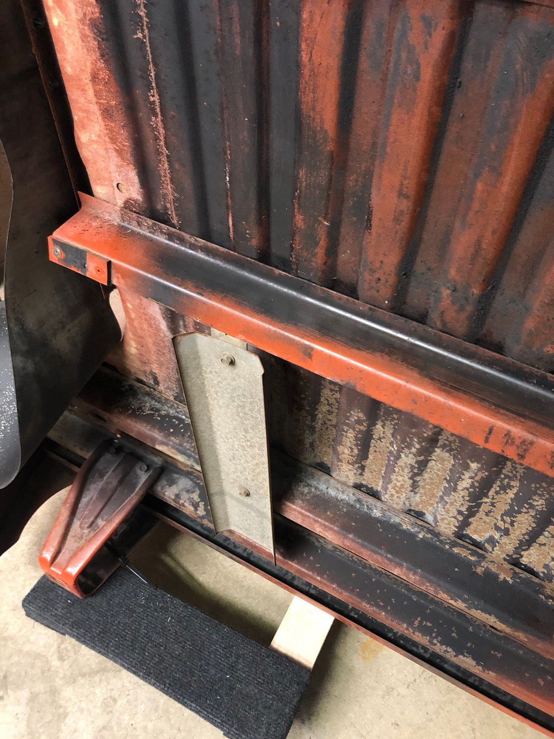

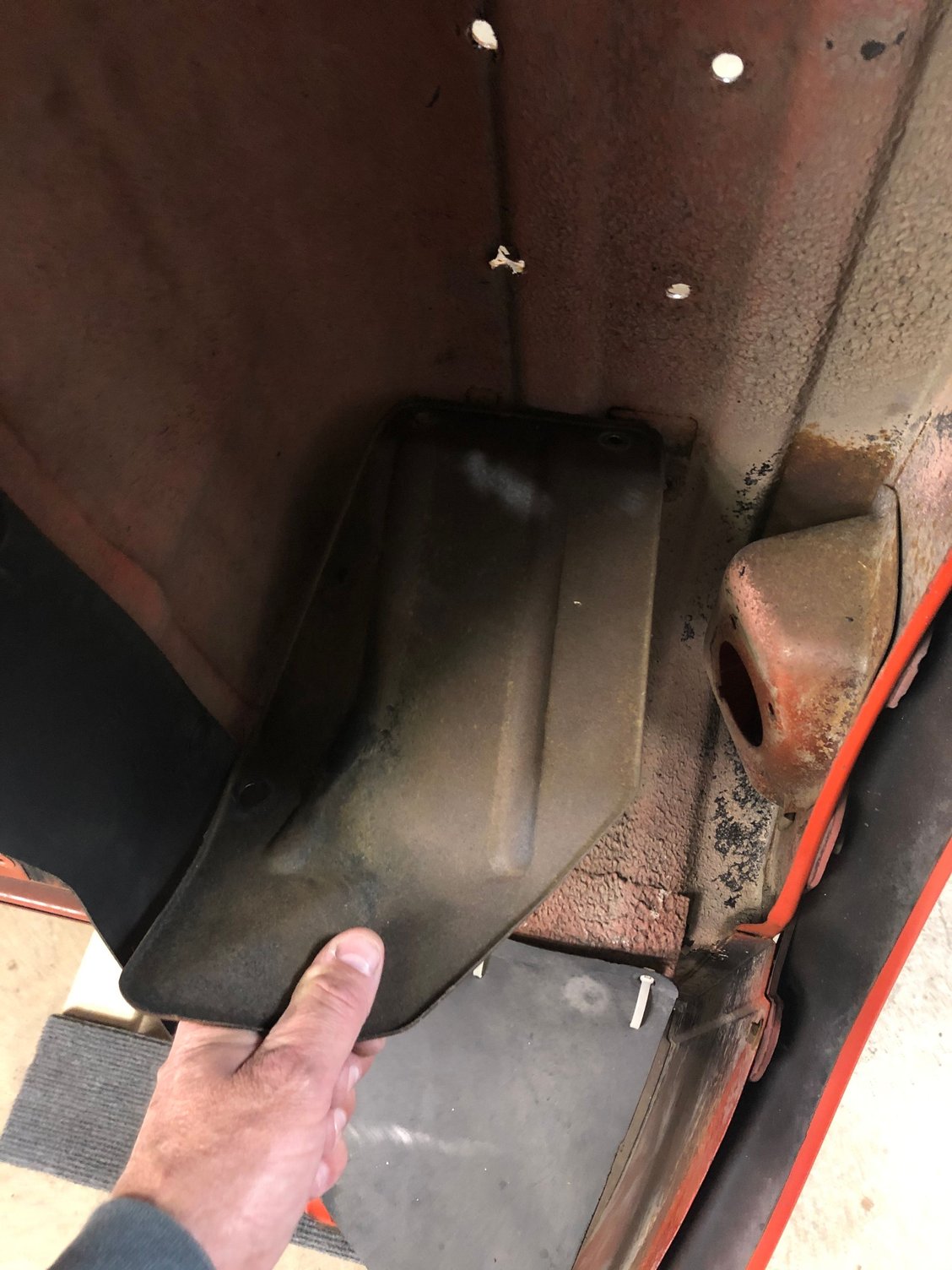

Not a long bed, but here you go.
Exhaust shield.
Fuel fill shield.

Thanks so much SMG - few pics in daylight:
