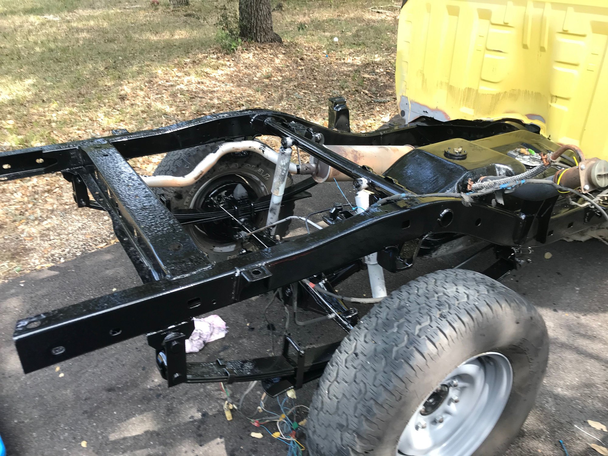

Replacing fuel filler neck hose/clamps & vent hose/clamps plus 4 x shocks - no mountain climbing intended - Any recommendations for a site/source I can get as close to OEM as possible? thanks in advance Brain Trust.

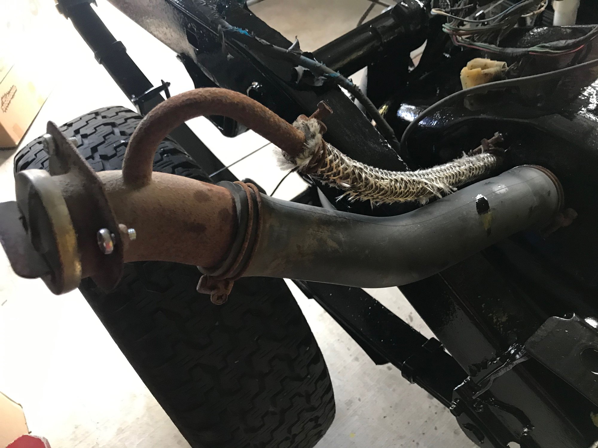

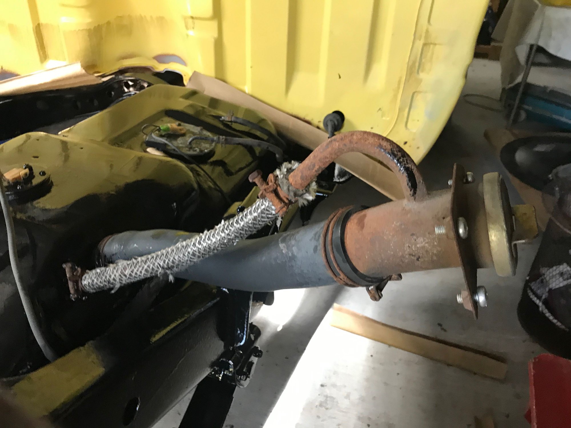

Thanks very much all - I'm on hold w/ Speedway Motors - Toyota dealer say parts are discontinued...Here's my specs for both hoses:
Filler Neck:
13.5” L x 2” OD. 52mm dia. (2”) Fits 50 mm (2”) neck pipe - fits neck 60mm (3.3”) at the tank.
VENT:
12”L x 7/8 (.78”) OD. 20mm dia fits 15mm vent pipe

Still seeking the dang hoses:1. 1x HOSE, FUEL TANK SUB INLET
77213
77213-35040
Filler Neck Hose:
50mm ID to 55mm ID
55mm OD to 60mm OD
2. 1x HOSE, FUEL, NO.1(FOR FUEL TANK)
77100D
90445-2188
3. 2 x small hoses from tank (fwd of filler neck) 1/4” ID or 6.5mm ID. 1/2” OD.
Lengths: 8” and 22” .
