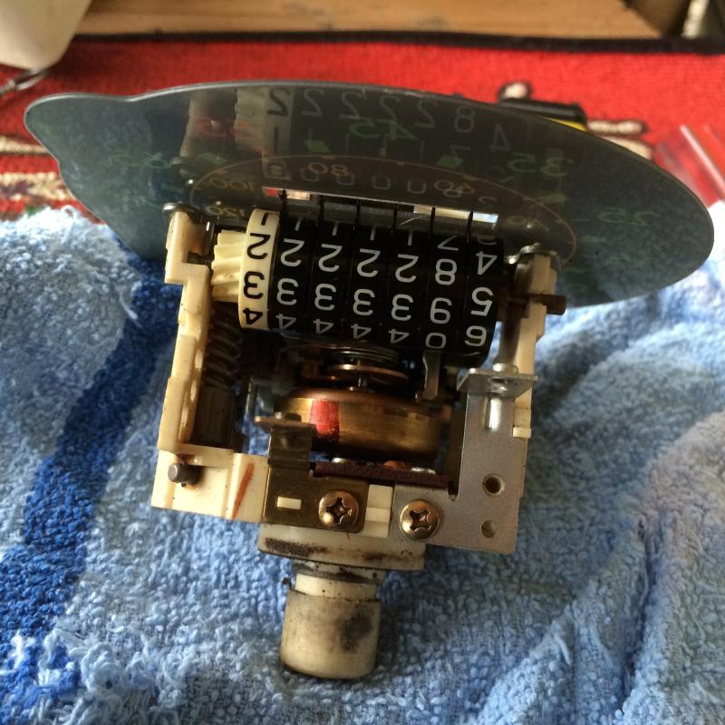

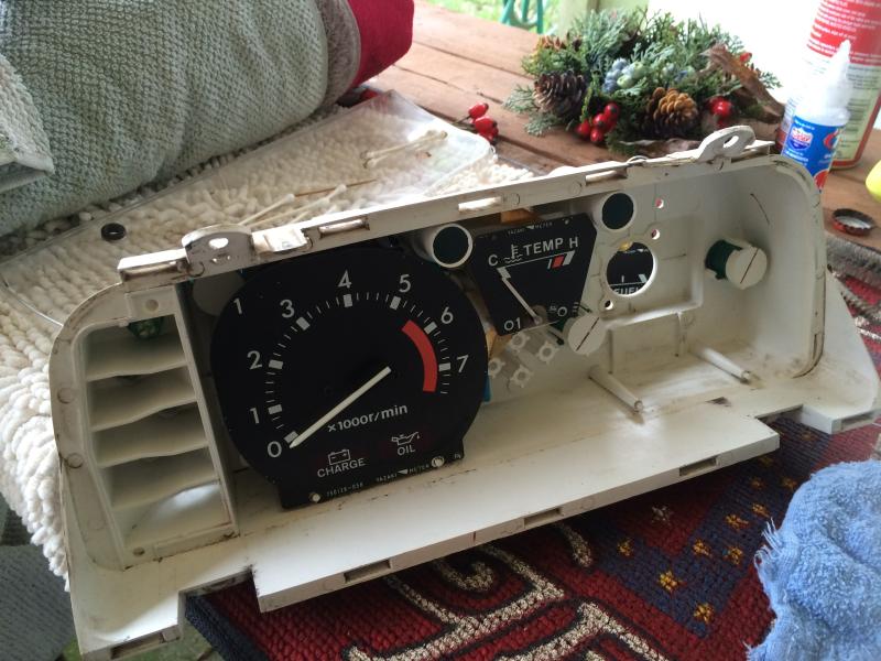

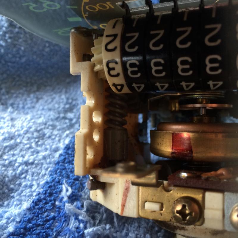

Pulled the cluster part today and was able to fix the issue for the moment. Gave everything in there a good cleaning with a pipe cleaner and a tiny bit of alcohol. I had to run the mech backwards for quite awhile to get it all lose. then i blew it out with a can of compressed air. Then i put it all back together and lubed it up. Worked for over a mile earlier on a test run. Also messed with my gas gauge and i might be trying to work again. Only time will tell on that one.
Here are a few pics for others who need to do this.
Installed;
Unit pulled;
Stuck worm gears;
hope this helps. it was a fairly easy job.

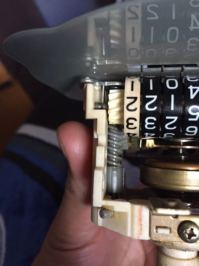

Bringing back an old thread because i am trying to fix my odometer that is not spinning. Everything else works fine including my trip only the odometer wont spin.
My question is does the needles just pop right off? Ive been trying to pop it off but it wont budge and id hate to break it.

Originally Posted by Punjab
Looking at the original poster's images it appears he unbolted the entire speedometer/odometer gauge unit from the cluster housing and accessed it from behind. Therefore leaving the needle and face plate all together.
I did notice that after i had posted my comment so i decided to do the same and not mess with the needle.
I am wondering if he just cleaned it as is or if he took it more apart from the back. I am not sure if i should be able to freely spin the dials and if so i cannot spin mine as is in place. Or would i have to pop them out to be able to spin it freely and clean it?

Originally Posted by 1st Gen Crawler
​​​​​​. I had to run the mech backwards for quite awhile to get it all lose. then i blew it out with a can of compressed air...
Stuck worm gears;
Attachment 123863
Attachment 123864
​​​​He rotated it in reverse to get the grit out of the worm gear. See the white gear with sand grit on the right and its matching gear below it.
Old 03-14-2018, 04:06 PM
Abraham Contreras's Avatar
Join Date: Feb 2013
Posts: 209
Received 42 Likes on 27 Posts
Thats what i am currently trying to do but the gear won't rotate either way. It has a tad bit of play to move back and forth but hardly at all.
