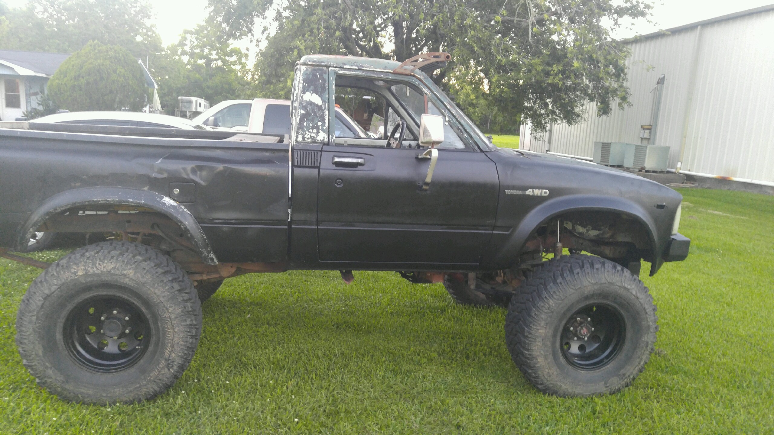

My name is William. I just picked up my first 81 Toyota pickup so naturally I'm going to have a lot of questions.
A little about he rig:
1981 Toyota pickup
6" rough country lift. 35" Cooper discoverys
5.29 gears. Stock motor and 4 speed manual trans
950lbs wench
Right now I'm having problems with spongy brakes. I've read I can replace the booster with a dual diaphragm and that will make a huge difference. What years will retrofit into my truck? Also any cheap ideas on how to replace my rear drums with disk? I've read you can use land rover disks and they are vented. I'm really just trying to go to a junkyard and snag some used parts rather than spend 400+ on a conversion kit.
