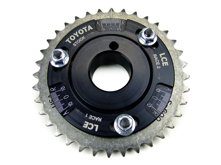

Here is a good clear picture. One tooth off is about 10°
You should verify TDC by pulling #1 sparkplug and using a touch test to verify (straw, dowel or *crinch* screw driver in the hole) that the piston comes to a stop at the top.
It's very much worth noting if you overshoot by any significant amount you can't just turn the crank backwards you have to go all the way around because the chain has so much slack on the tensioner side. Somewhere/when I've posted the video of this showing the cam won't move for about 15° (from memory) of crankshaft rotation.

The adjustable cam sprocket was just to illustrate the ten degrees between the peaks of the teeth, however..
How much material was taken off your head and block, this effects the cam to crank timing by retarding the valves. It might actually be advantageous to install the adjustable sprocket. While it is possible to tinker with the valve timing I don't expect many people are doing a lot of tweaking it and feel it's safe to say most are "set it and forget it" only doing it once.
You should check the TDC and verify the indicator points at 0° when it should and there isn't an issue with your casting mark or the pulley hasn't slipped on its rubber ring.
You should verify the location of the cam dowel when the piston is at TDC. (It should in the 12 o'clock position) If this is ten degrees off you can move the cam, but if it's five out your only choices are live with it or install the adjustable to get the power band back to design specs.
