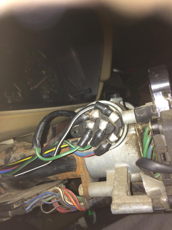

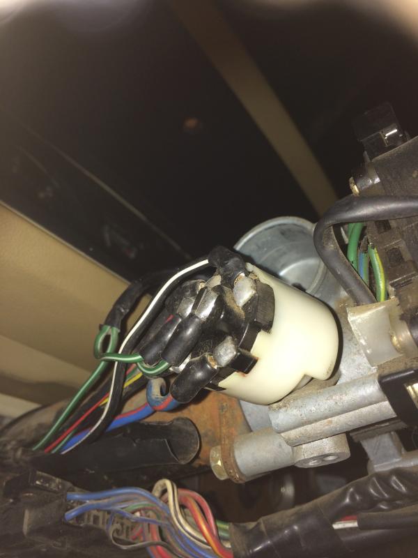

I was fixing some stuff in my truck to day and it does not seem possible for me to fix one issue without causing at least 1 or 2 more. Got the odometer fixed today, put it back together now i am having issues with my ignition. I traced it down to the white "thing" that is on the driver side (non-key side) of the ignition. Mine is janky and will cut in and out, when it goes out it cuts ALL POWER and my truck stalls out till i give it a few good smacks, or fumble with it for a few seconds. I have to drive on I-5 tomorrow and i really don't want it to crap out on me/
Anybody know an P/N for this piece, or if they are known for problems like this? I would like to get the whole dang thing replaced if possible (ignition, switch "thing", and key set.

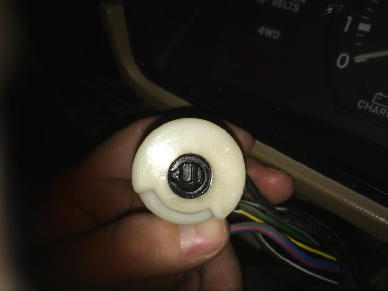

i bought a lock cylinder for what was supposed to fit an 82, was far too long, now its in the parts bin.
Here is what i am working with;

Most of my issues seem to be steaming from this bottom blue wire. It seems a bit loose, but hardly, and all the sodder is still there.

I got the ignition (part the key goes in) it's almost a prefect fit, but might be a bit too long.

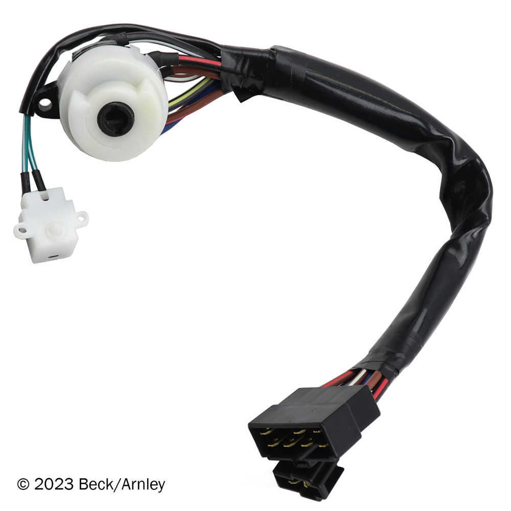

Anybody know anything about the extra wire that goes from the electrical switch to the part the key goes in? Mine has one, but the replacement parts do not. what is it, and do i need it?
This is the one i think i need. http://images.wrenchead.com/smartpag...A2011410-1.jpg

Hey, new member here, but I'm in the same boat, just bought this for my 82'
The last one on the page is no steering lock/no tilit...I just bought yesterday.
Last week I bought the first one on page....didn't fit.
Should get part in Thursday, I'll let you know if I did right, this time.
Christopher
http://www.partsgeek.com/catalog/198..._cylinder.html

Presto!! Got bingo, was a tic to get key in right selector position for it too accept.(Accessory) I did put a bit of graphite on cylinder in key location & sprayed Corrosion X on the internal terminals for control.
& Yes $60 + $8s&h is a bit steep, but better than paying/returning/shipping wrong part for 30-40 bucks & $90 @ local twilight(auto) zone & ($104)oreilys......all had wrong cross-reference numbers.
The blue/red wire is the ACC wire at the Ignition switch, that powers the cigarette light and radio fuses. The battery power wire to Ignition switch probably is black/red through a Green fusible link.
