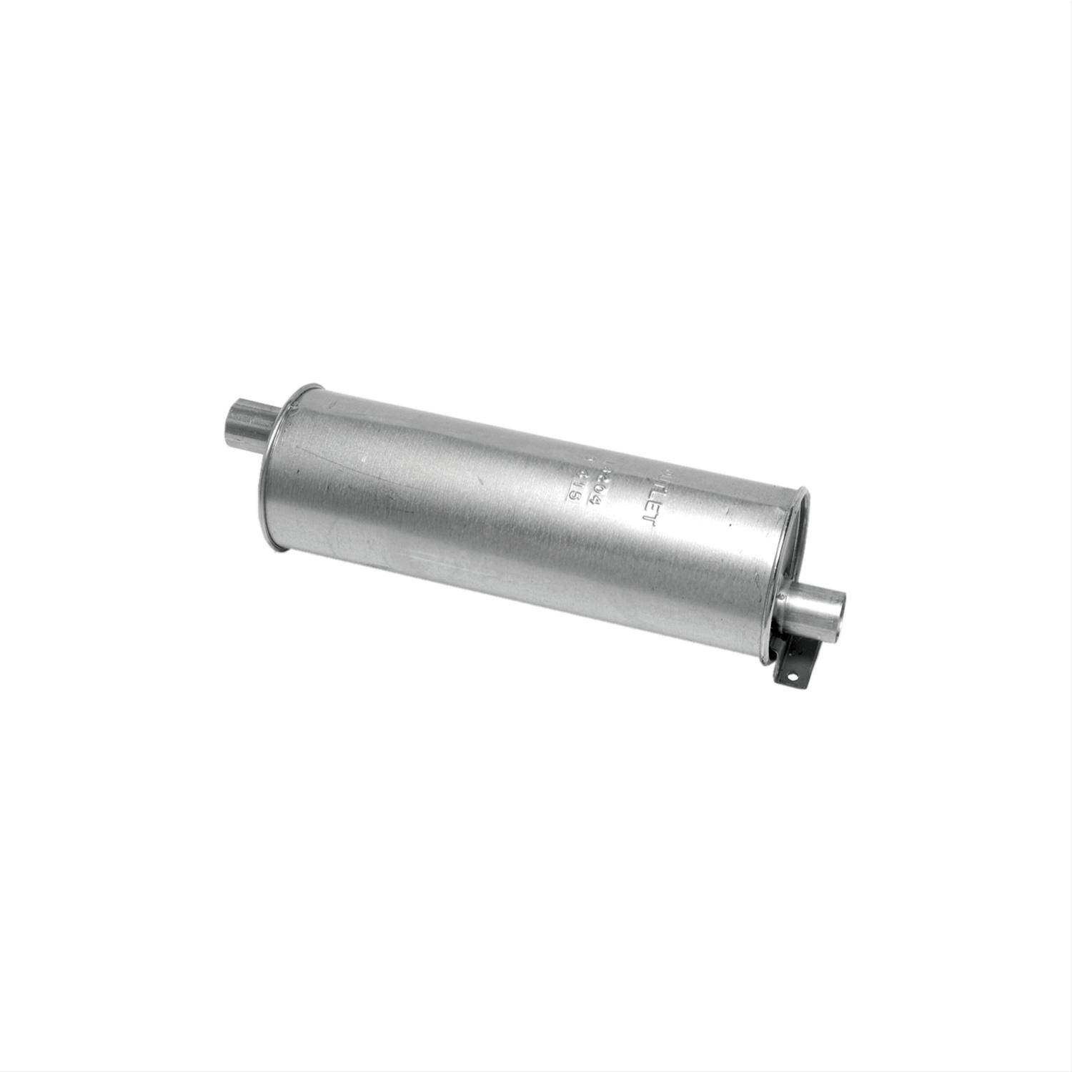

My 1982 pickup needs a new muffler, the old one is good and rusty. However I had no luck finding one with the factory hooks installed, the closest I could get is the one attached to this post.
Would anyone know what sort of muffler strap I can use with this unit? Has anyone replaced their muffler with this and if so, how did you do it?

Just took mine off yesterday. The one in the pic is like the one I have. Bought it at Autozone I believe.
There is a hanger that bolts up directly to that muffler.
If you don't have the hanger, maybe Ebay?
I'm redoing my whole exhaust system, but I'm not sure if I'll be using mine still.

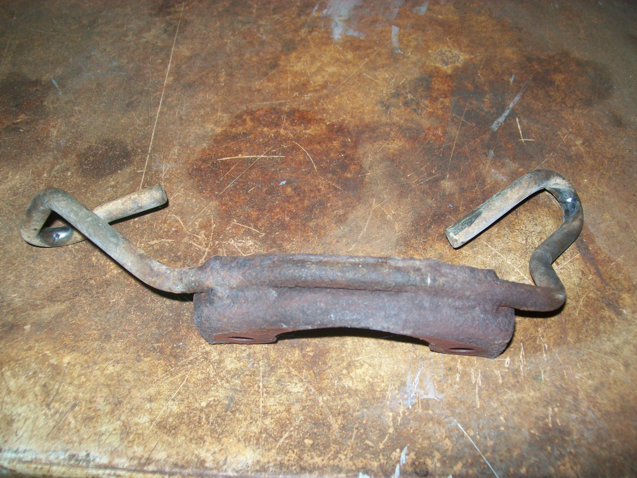

Here is what I took off mine in the first pic. It bolts to rear of muffler.
Second pic is the hanger that bolts to rear of cat.
Third is my old muffler.

I bet you can make it work though.
