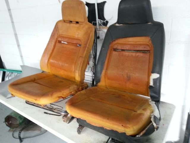

I have a 1981 Truck. I believe it is the SR5 since it has a Tach and wood on the dash.. I was told it is the black edition. Someone replaced the seats with seats from an Acura. I was able to locate replacement seats and I want to get them upholstered. The seats I got are perforated tan vinyl.
I am hoping to get some help with this. Did they come in regular vinyl or perforated vinyl? I am planning to have them in black but I am wondering if the bottom skirt section and sides should be gray or was the whole seat black?
Any help is greatly appreciated.

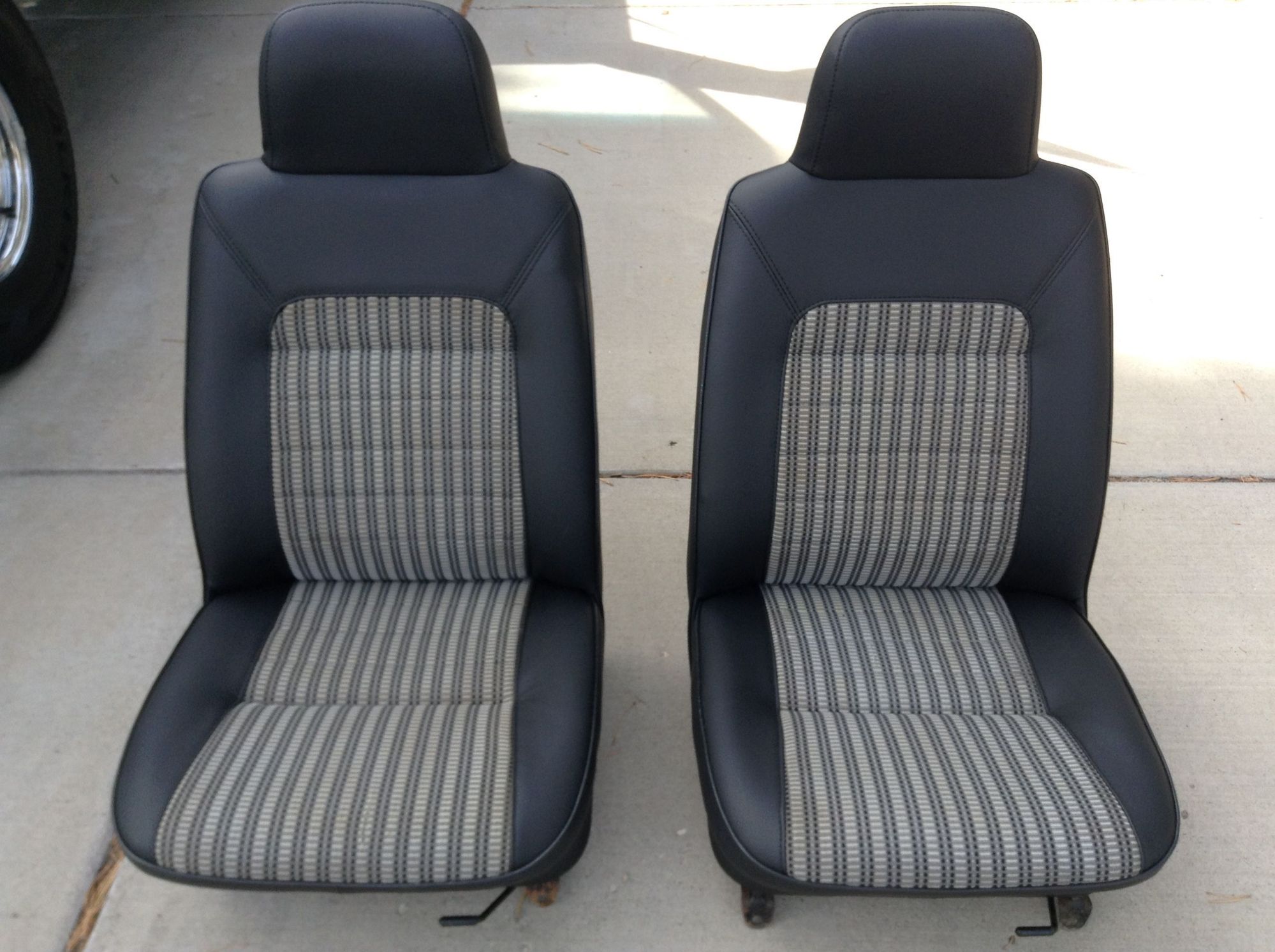

AFAIK the '81 SR5's seats had a cloth center & vinyl sides like this one: https://www.autoevolution.com/news/s...s-152474.html#
Those look to be the original pattern for the Black Edition. A few others I found had aftermarket seat covers.
With a little searching around I did find a few with all vinyl seats, with the center sections being a contrasting color (center medium grey, outers black) but do not know if they are original or not. I couldn't find any info on options.

Yes, the seats above are correct.

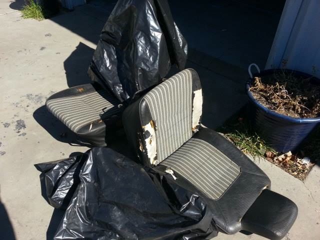

The 1979-81 SR5/Sport trucks had the fixed backs and built in head rests. The 1982-83 SR5 trucks had the adjustable seat backs with adjustable/removable head rests. The SR5 logo fabric was used in the 1984-1988 trucks and 4Runners which you could use as the center panel. The center panel on the 79-81 trucks is no longer available but is made of a very thick fabric. I had the upholsterer re-use the original center section. He just cleaned and repaired any holes in this section. You can't tell of the repairs unless you look very closely. If you do have the seats reupholstered, consider having the seat foam replaced as well as it makes for a "like new" firm seat. After 40 years, the foam looses its support for the fabric and your butt.
