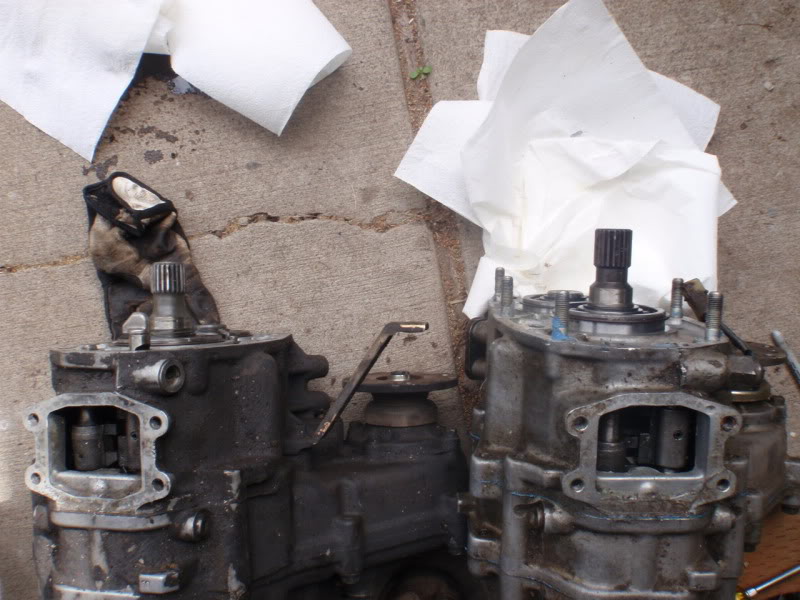

Ok here are some pictures I snapped. Sorry for poor quality but its the best I got.
Couldnt get a shot of inside the tranny.
So thats the sleeve I was talking about, I dont know the technical name for the part. So obviously the splines match up but Im thinking that the are too long on the transfer case side? Also the thing has a death grip on the splines, I cant budge it off my transfer case.
Any insight would be appreciated.

That is the spline coupler out of your transmission. You can see you also pulled the output seal out of the transmission..You didn't have the input shaft of the T/C aligned properly.
what transmission?
are you sure you did not try to force a 21 spline input into a 23 spline transmission? R151 or the original L50/L52 5 speed..

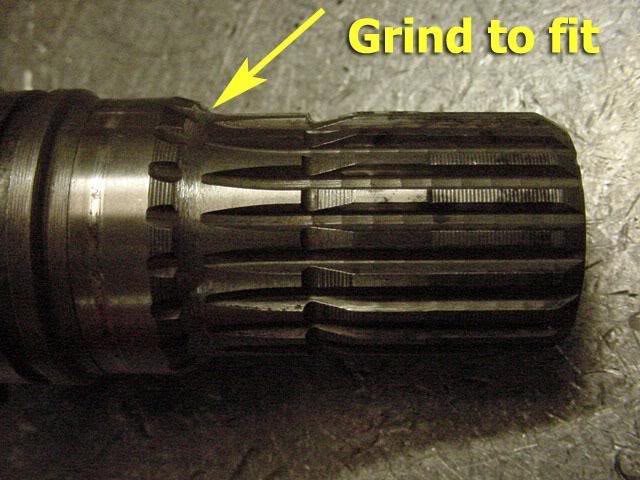

just remembered this little fact about some transfercases out of 79-80's that had an L43 transmission (side shifting 4 speed)
some have to have part of the input shaft ground off (see pic on right)

I was thinking about the fact that maybe I didnt have the right spline counts but when I went to install it slid in easy, only resistance I got was near the end of tightening it down on the transmission. Looking at those pictures, the transfer case I used for the donor does have the stepped bit on the spline shaft, so there is a possibility that I have the spline count off.
If that is the case, can I get a spline coupler that adapts to a 21 spline? or should I just bite the bullet and swap the cases around and use the reduction box that originally came off the transmission? thinking that the coupler is probably toast now if I forced it. Or could I grind the step off so it fits into the coupler if the spline count is right?

if it is the L series than it should be 21 spline
here is the pic I was originally looking for that shows where you would need to grind the 79-80 shaft
if you shafts look like either of these two you should be fine

Thanks drop! I got it all figured out and ground down yesterday! Dual cases with Marlin adapter, raddesigns triple stick set up and trail gear dual case cross member all in! Just need to shorten and lengthen drive shafts and she'll be ready to sit in my drive way for a bit longer.. Hahah
