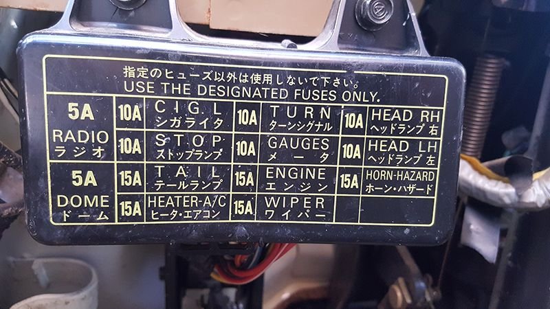

First off, does anybody have a similar truck and can take a picture of the fuse cover? Searched google but all I could find were covers for FJ's. My cover is long gone and have no idea what fuse is which. To make matters worse the PO replaced most of my fuses with 30a fuses. I had some troubles with the radio over the weekend but was able to fix it by fiddling with the fuses, so I am planning on going through all and cleaning up the connections and putting new fuses in.

Here is the fuse cover from my 79 pickup, hope it helps...

Thanks Vitod. Unfortunately the 78 uses glass fuses all in a line. Guess I'll have to do it the old fashioned way (pull each fuse one by one and see what turns off)
