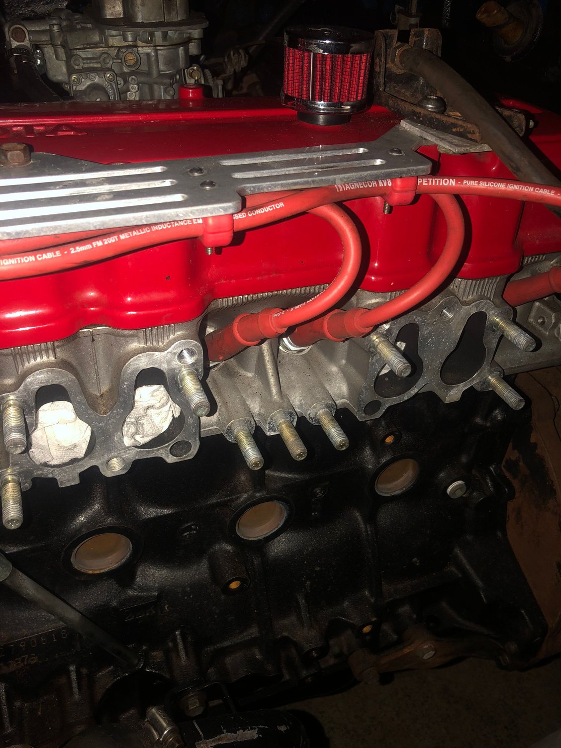

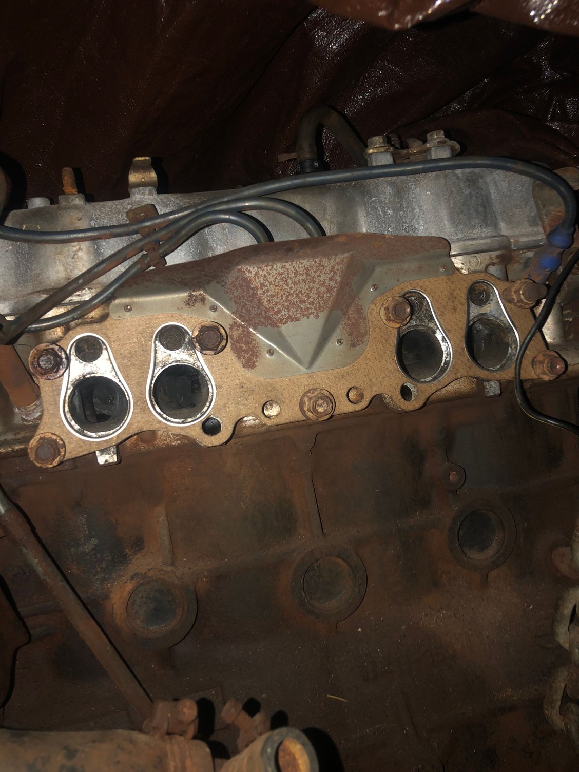

I hope this helps but the first picture is a 22r and I have 3 header bolts on the bottom. The second picture is a 20r and has 1 header bolt on the bottom. on LCE Perforcmance they have this gasket for 20r https://www.lceperformance.com/Pro-H...-p/1040006.htm
