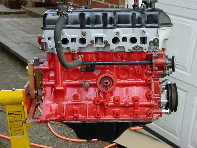

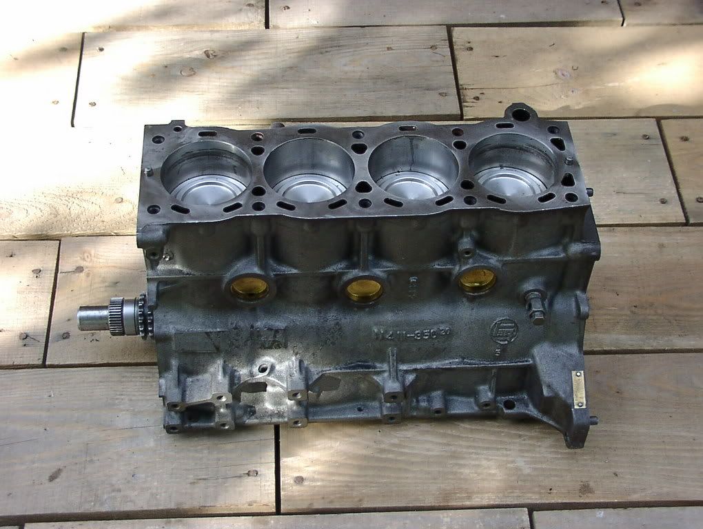

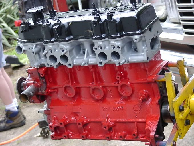

I went from THIS
To THIS

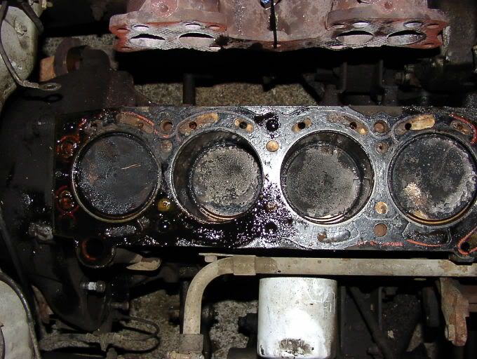

Photo of the old block, head off.
You can see on the intake side where ALL FOUR of the bores had bad HG seal. #4 was the worst, and had the least build up due to steam, but you can see the 'sliver' of clean piston on #'s 1, 2, and 3.
Looking back it appears the engine was just fine....it was simply a combination of the buggard vacuum advance, and the blown headgasket that was screwing up my power/economy.
Oh well... I have a Hybrid now!
