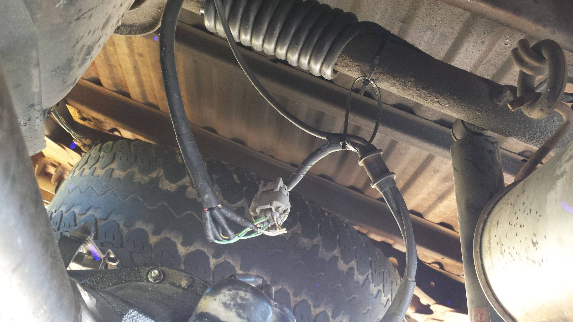

Used PCV grommet here to seal wiring
Didn't want to cut wire till I was for sure this was going to be my permanent route, so I wrapped it around upper shock mount. Received pigtail north of short harness so tied in there instead of cutting sub harness. Will eventually make this prettier was ready to test and burnt out when I did this part.
