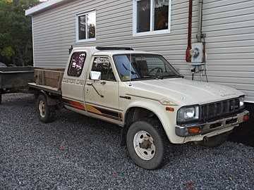

Can you post pictures? Maybe it is a rare extra cab, and nothing else but an extra cab will bolt with minor fitting. If it is an extra cab it might be worth saving the body you have there since it is super rare.

Something like this but for 79-83, this one is an 85. I have seen one in my life, the frame is much longer.
Old Mar 30, 2014 | 05:27 PM
gillesdetrail's Avatar
Joined: Jan 2013
Posts: 803
From: Montreal, qc
This is what I've see before, is this it?

they were made by Winnebago and are fiberglass

Close enough. But that is it!
