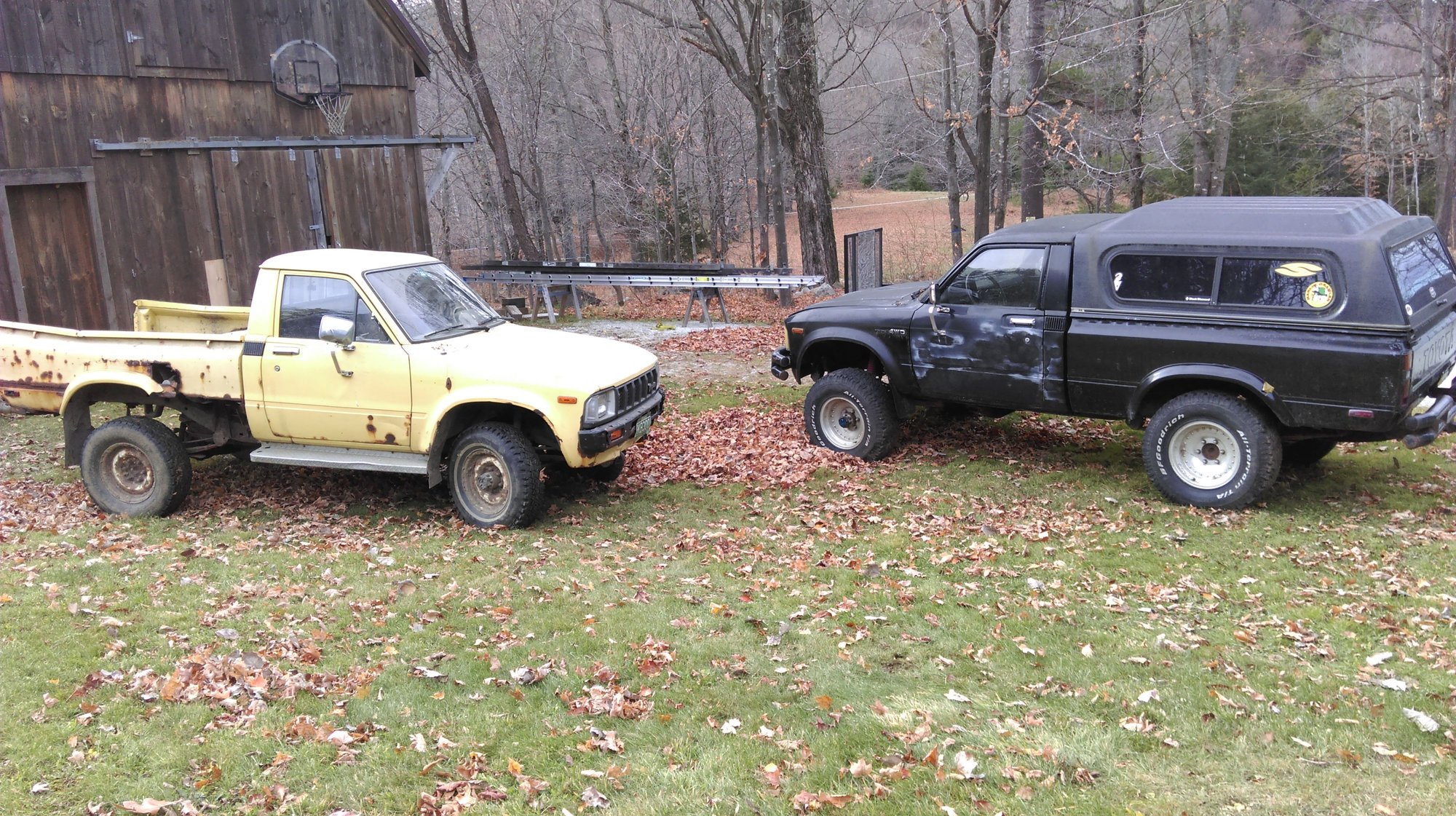

I've got a 22r from a donor rig that has 35,000 original miles on it. Starts easily, idles smooth, runs great. I am starting to entertain the thought of what, if anything I should do to the motor. Super or turbo charger, propane, basic rebuild, full blown overhaul, or just stick it in the replacement truck and drive. Thoughts? I just posted pictures of the trucks in the picture thread, but here's one again...
