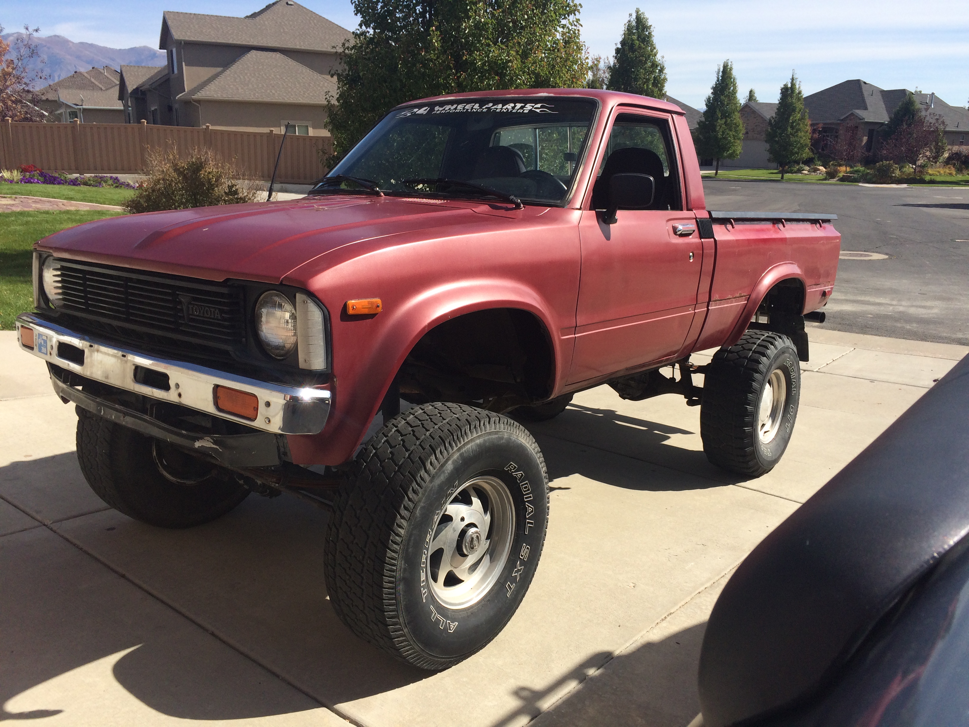

When we picked it up.

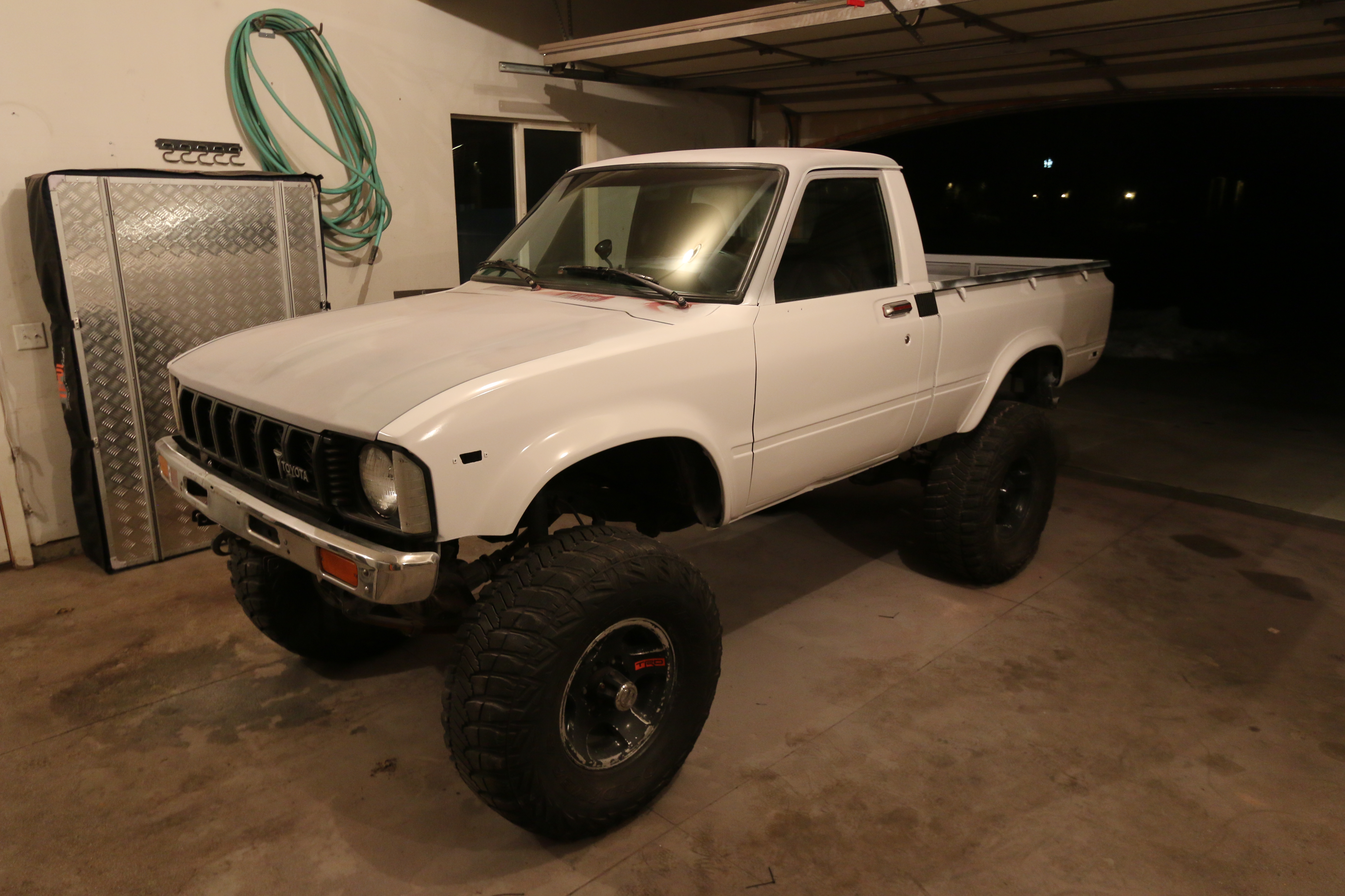

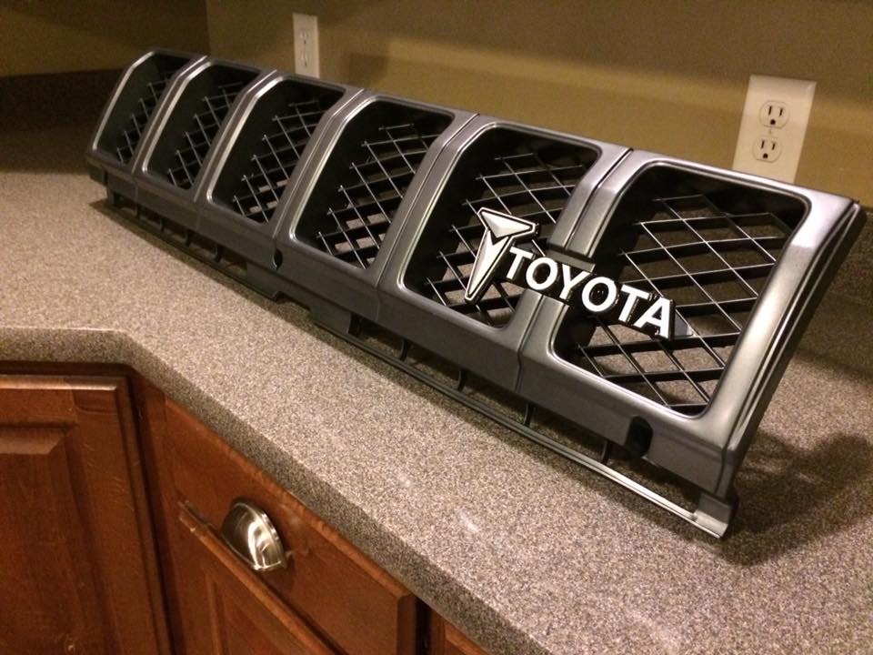

Got a new grill from an '83 with a few mods to work with the round headlights.

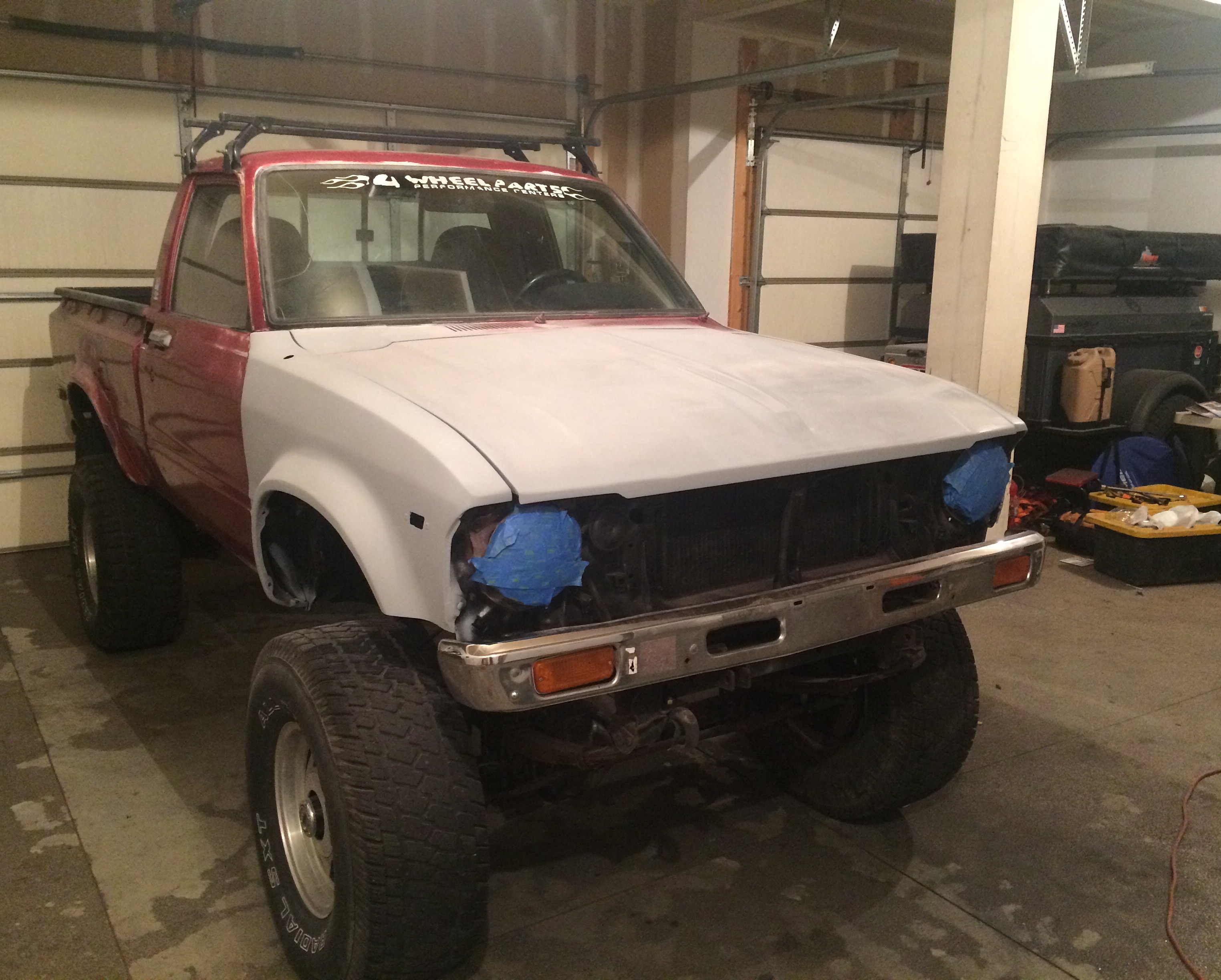

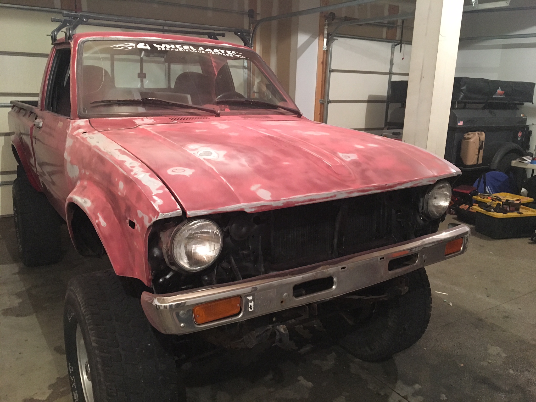

Body sanding

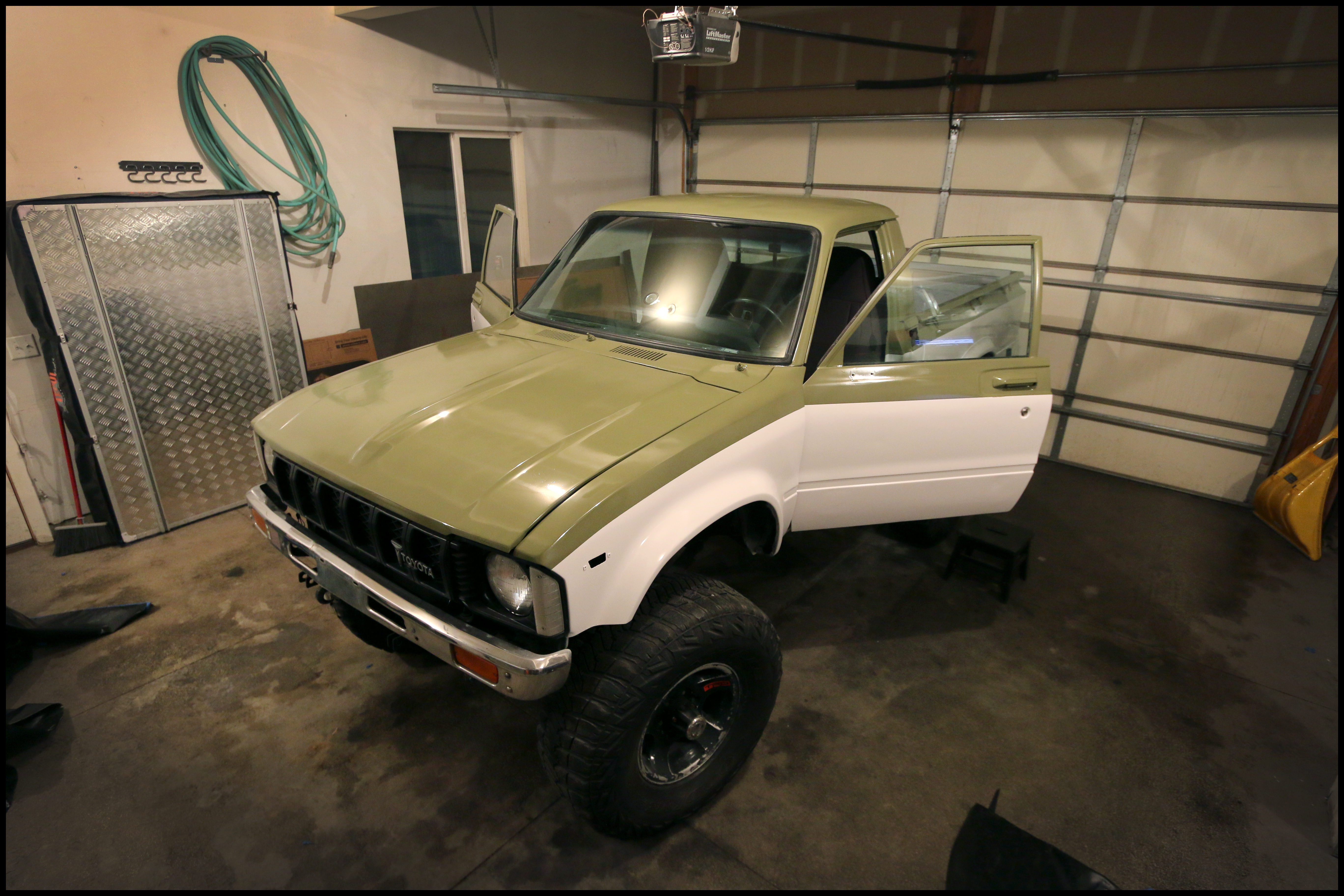

Current condition. Passenger side has been cleaned up and primed. Need to finish the driver side, then hopefully get paint on it before it's too cold.

Does anyone have any info on these fiberglass fenders??? I have not been able to find any info on them anywhere other than that they might be from Canada?

Hey Adam, that pic's not coming up. Could the fenders be from this guy? https://www.yotatech.com/forums/f209...-build-285276/

Placing a year can be confusing. it depends which month it was built. If it was built in 02/79 it will be a 79 if it was built in 11/79 it will be an 80. I'm not positive which month it changes but I believe its at the end of June.
There are a few companies that build fiberglass Toyota parts. Corey in Penticton, BC has a company called toyotafiberglass.com. I've bought his box, fenders, tailgate and cowl and its all great stuff. I can't speak for the quality of the American companies but I've heard people who have bought both say its lower quality than what Corey puts out. It will be a nice looking truck when its done!
Yes that's the one. I already sent him a PM and got a response. Looks like shipping a single set from Canada isn't very cost effective. I suppose I could try to put a group buy together since it sounds like 5-sets would cost the same as a single set to ship? It's not a critical part of my build, although I'd really like to do it. Just gotta give it a bit more thought and see what I can do to get a set.

Nice looking truck! Put some safety glasses on the kid! Those wire wheels throw stuff everywhere. Especially little pieces of wire that like to find eyeballs. Rockauto has the correct grille. They have a lot of parts for these trucks. I've bought parts for mine from them and never had a problem http://www.rockauto.com/en/moreinfo.php?pk=704106&cc=1277120&jsn=364

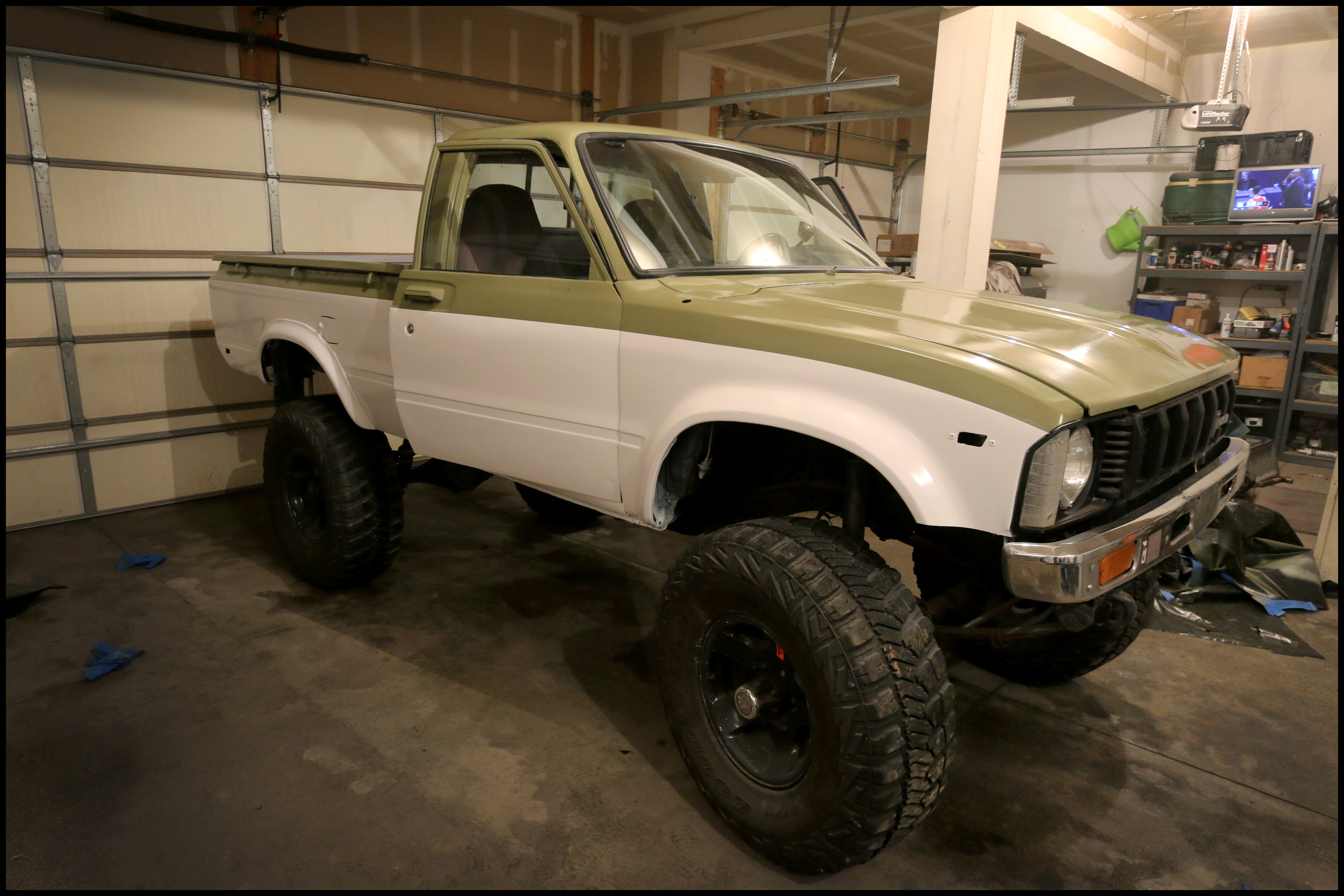

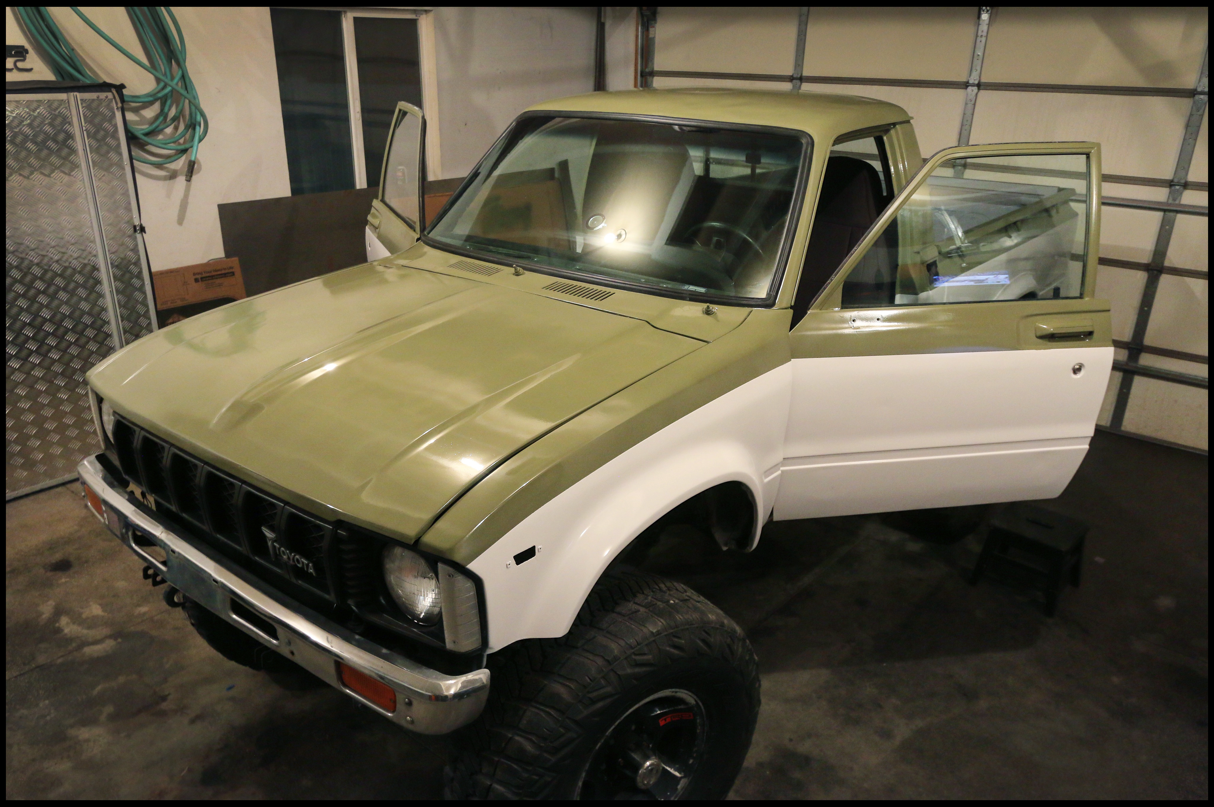

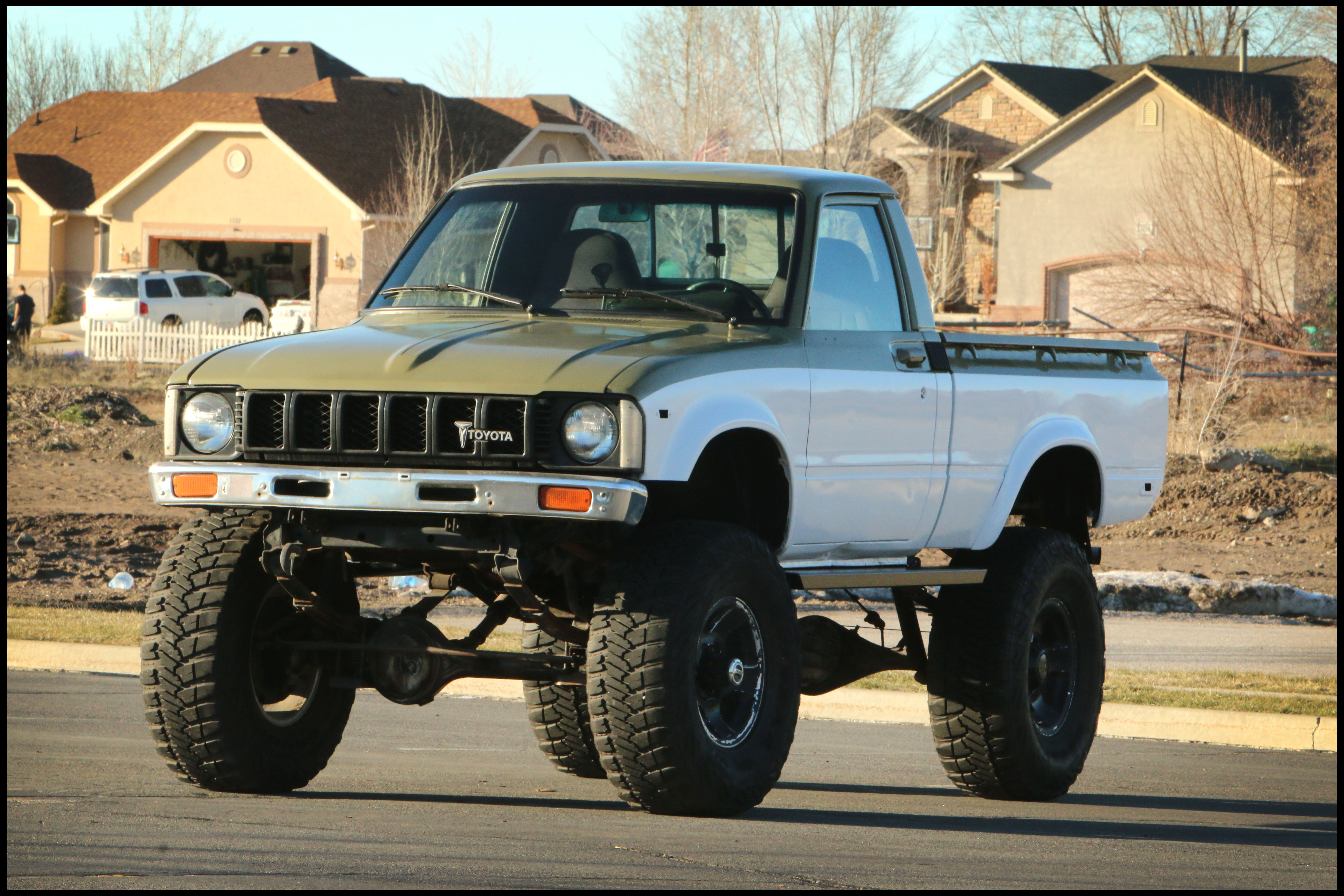

I got the clearcoat sprayed. It came out ok, but it's a $150 paintjob so definitely not perfect. It's a "ten-footer", looks good from ten feet away. I think we'll do a bit of wet sanding to smooth out a few spots and call it good.

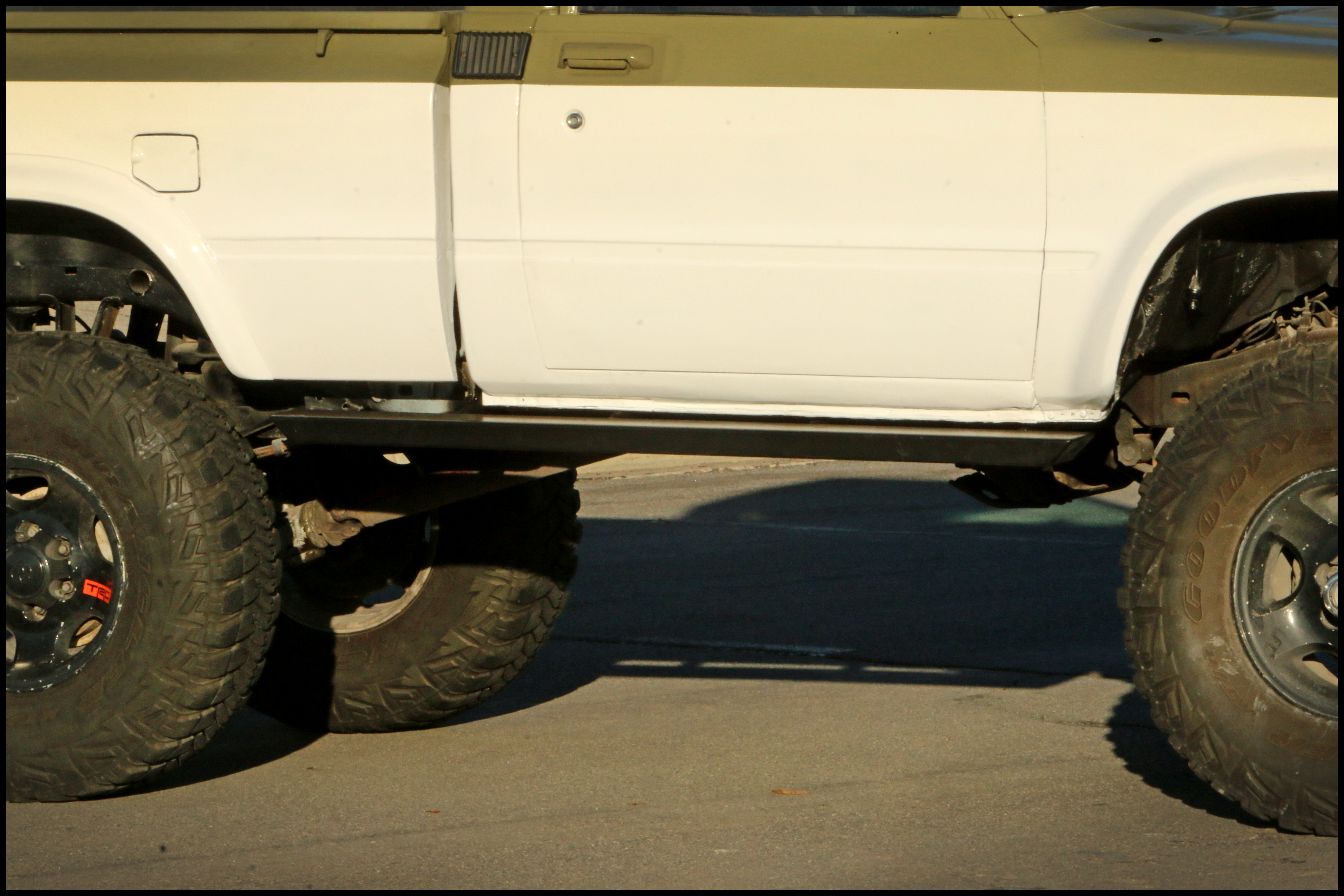

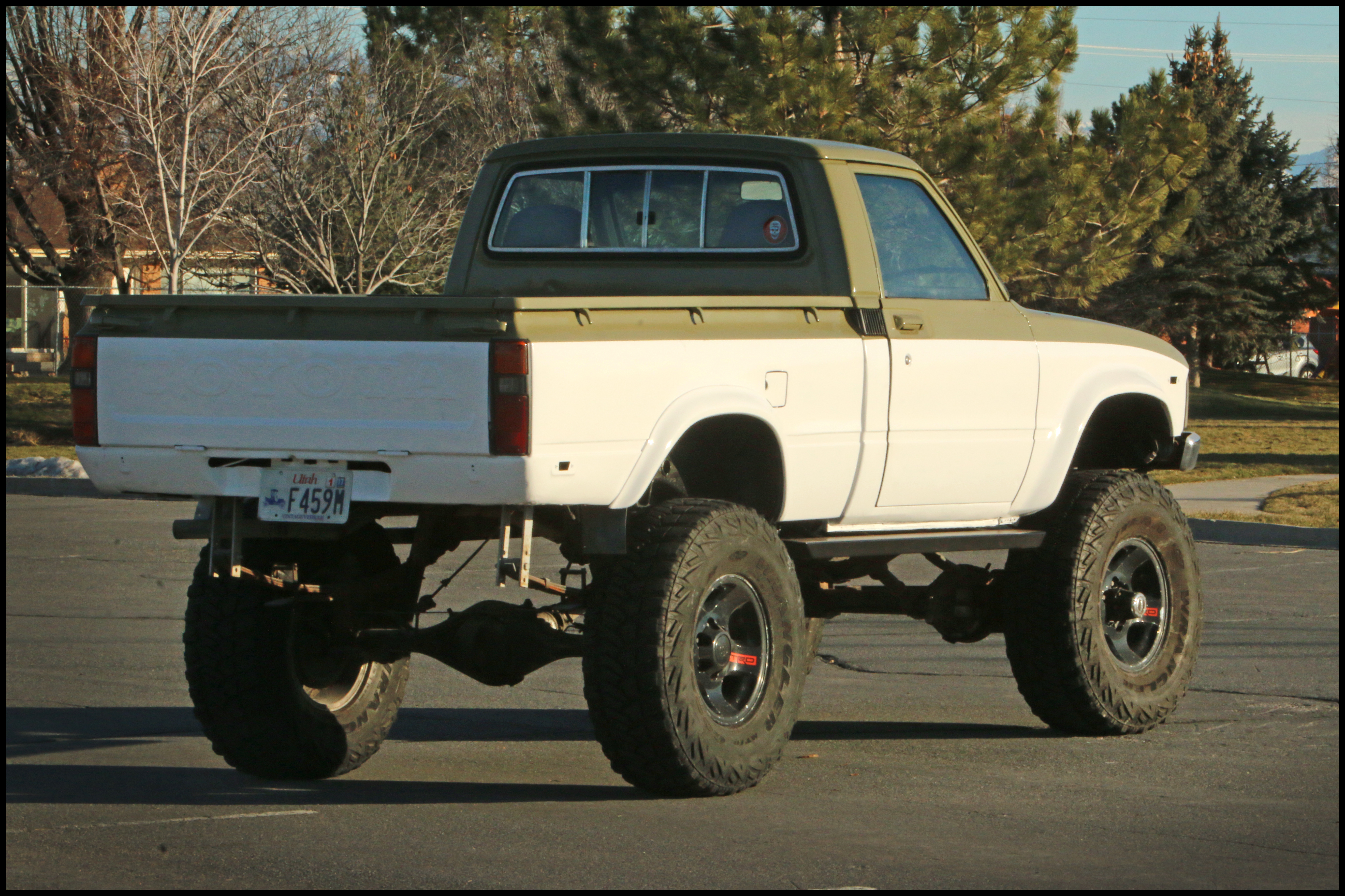

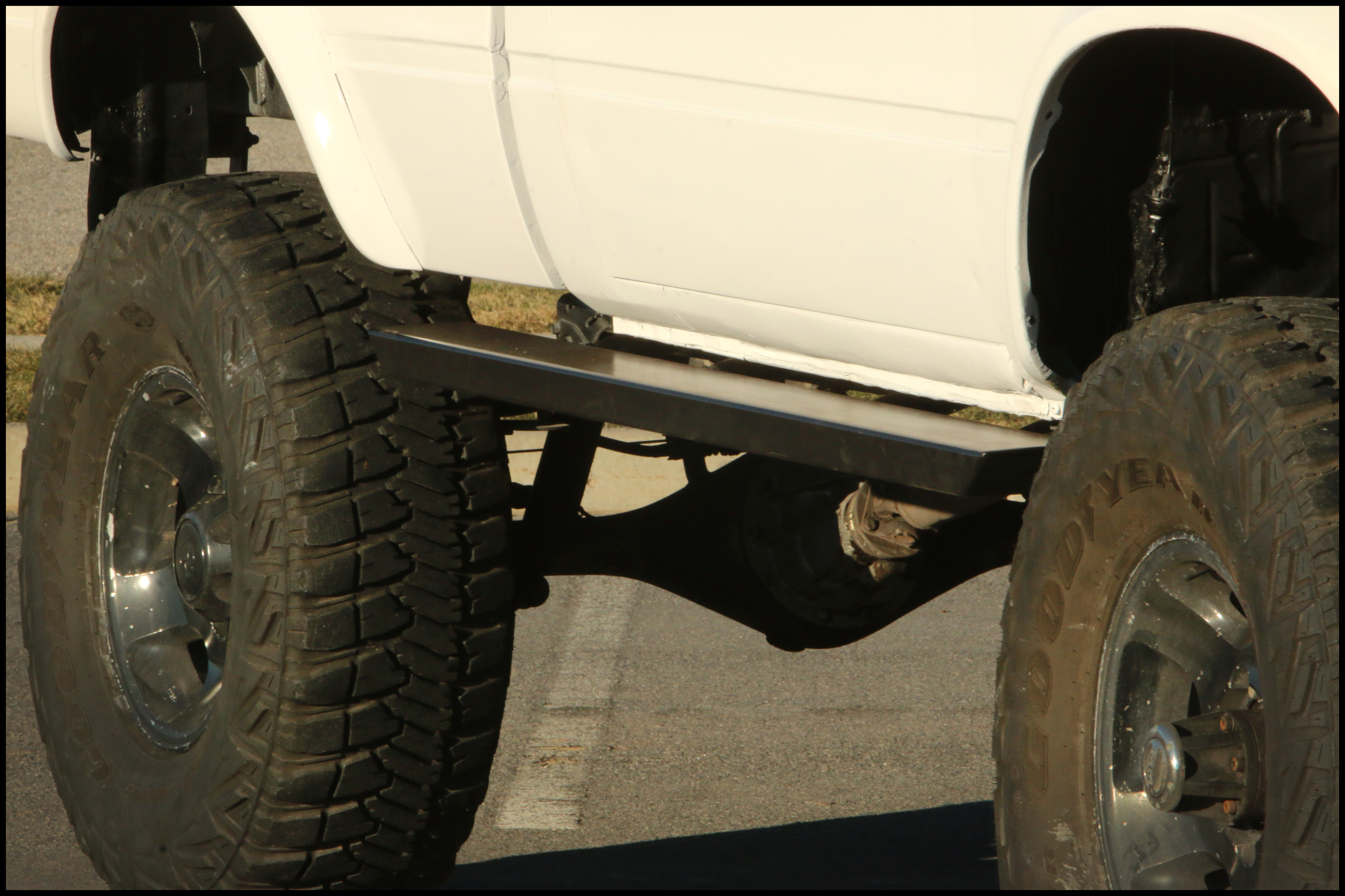

Also got some sliders built and mounted. These are massive overkill on this truck but I guess that's not a bad thing. We wanted a bit of a step to make getting into the cab easier and still have good rocker protection. Round tube could have worked but it's the best step. I decided to use 5x2 3/16" wall rec tube. They are heavy duty! I have no doubt they are stronger than the sliders on my 80. Anyway, simple no frills, descrete and good protection with full coverage of the rockers and should keep the doors away from rocks. Welded to the frame with 4 gusseted legs.
Next up is a suspension overhaul, and addressing the front axle that has numerous issues.

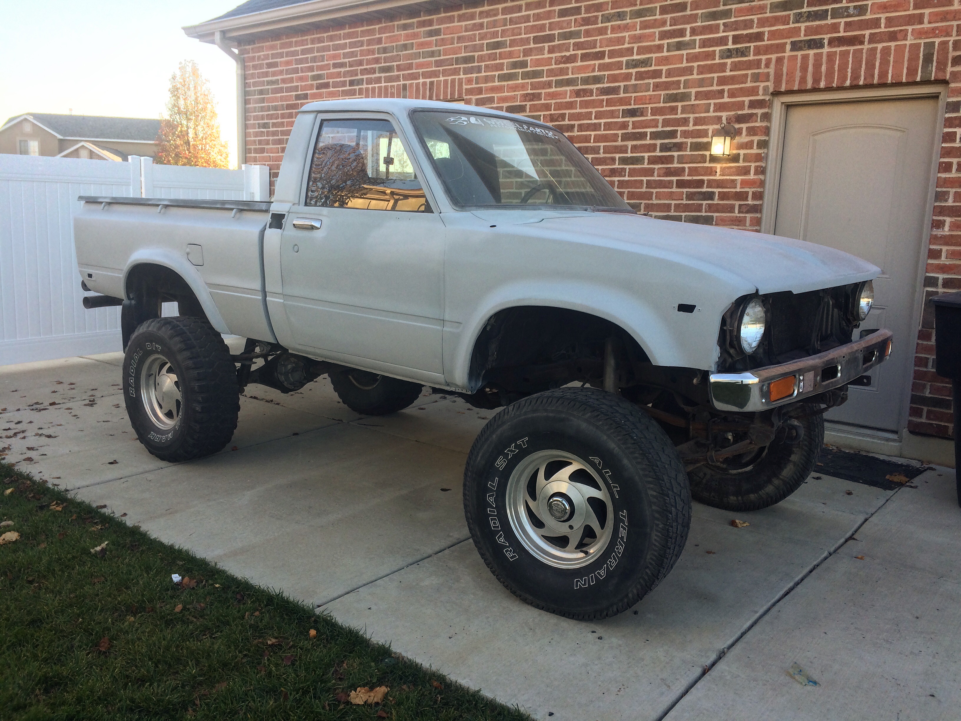

Yes I know the camber looks completely wonky. Likely bad bearings but I need to check for a bent housing. It's not as bad as it looks in this photo because the wheels are slightly turned which seems to exaggerate the effect. Look at the pic from a few weeks ago with the front wheels straight and you can see it's definitely not as wonky.

Sliders

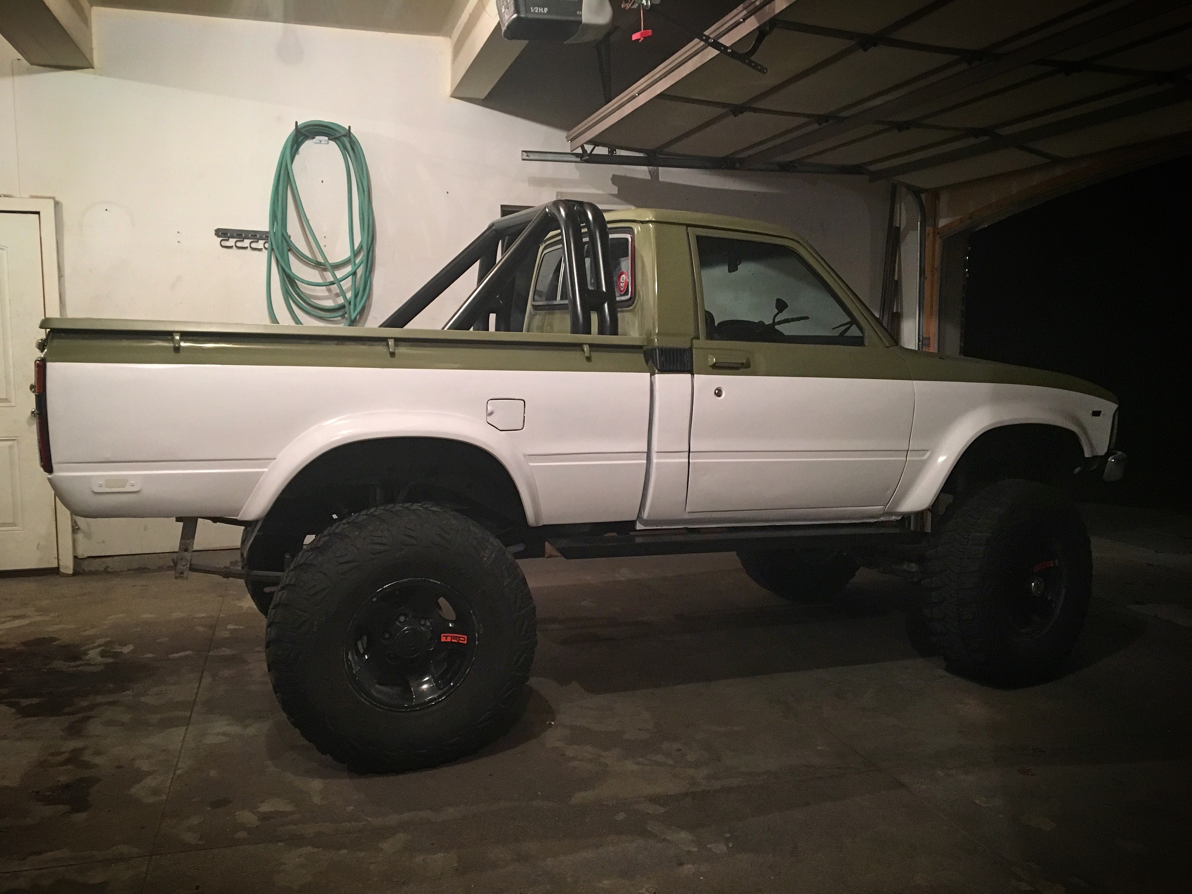

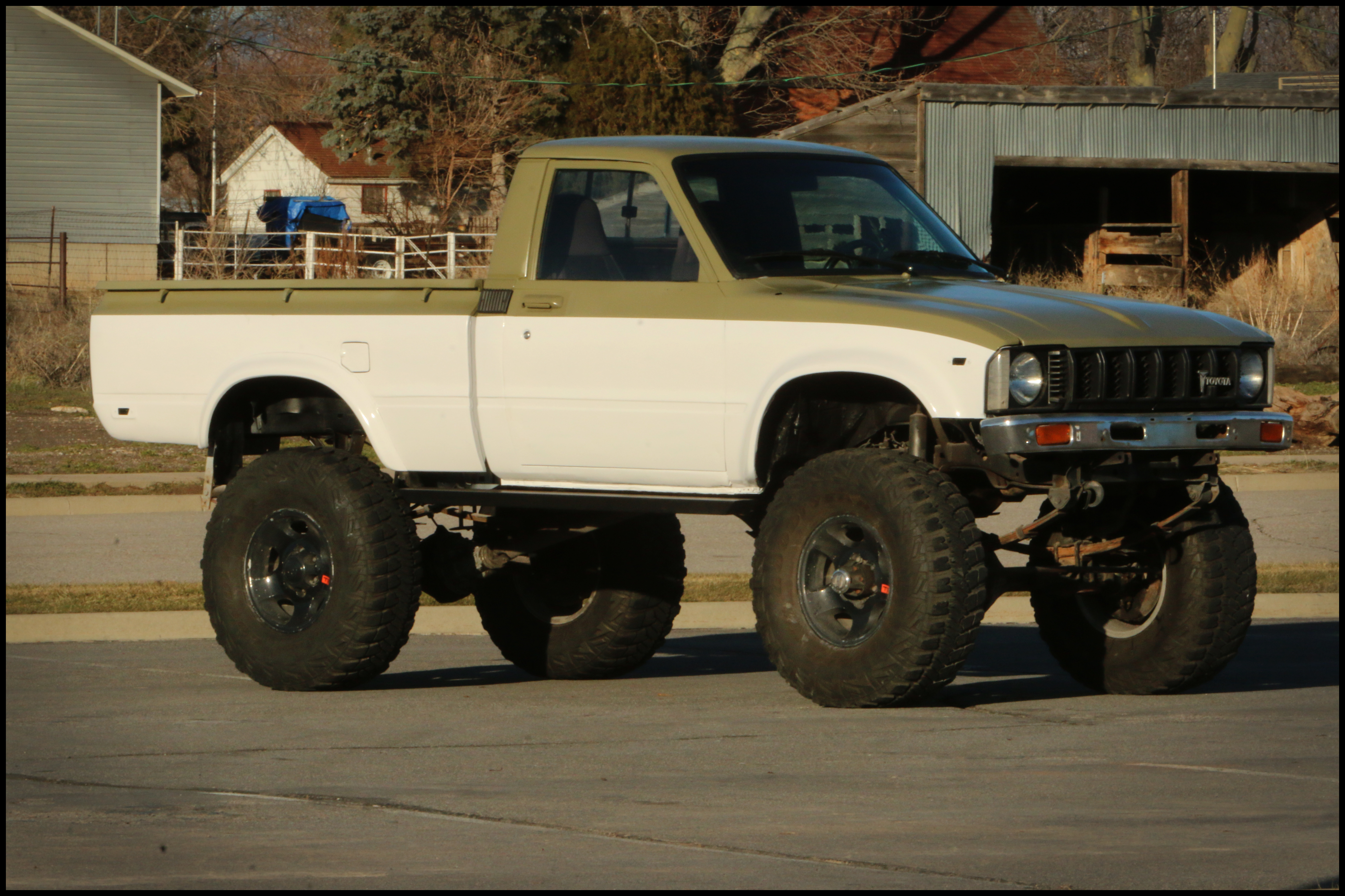

This first pic was from last week. Little old school style with the double-single rollbar. I got this from the PO when I bought the truck but it was in rough shape. Also I hated how these were a little tall. It was probably more "functional" with the main hoops being about 2" taller than the roof, but just looked weird. I cut the main tubes down a little and I'm much happier with the look. We cleaned it up and repainted it and now it doesn't look to bad.
