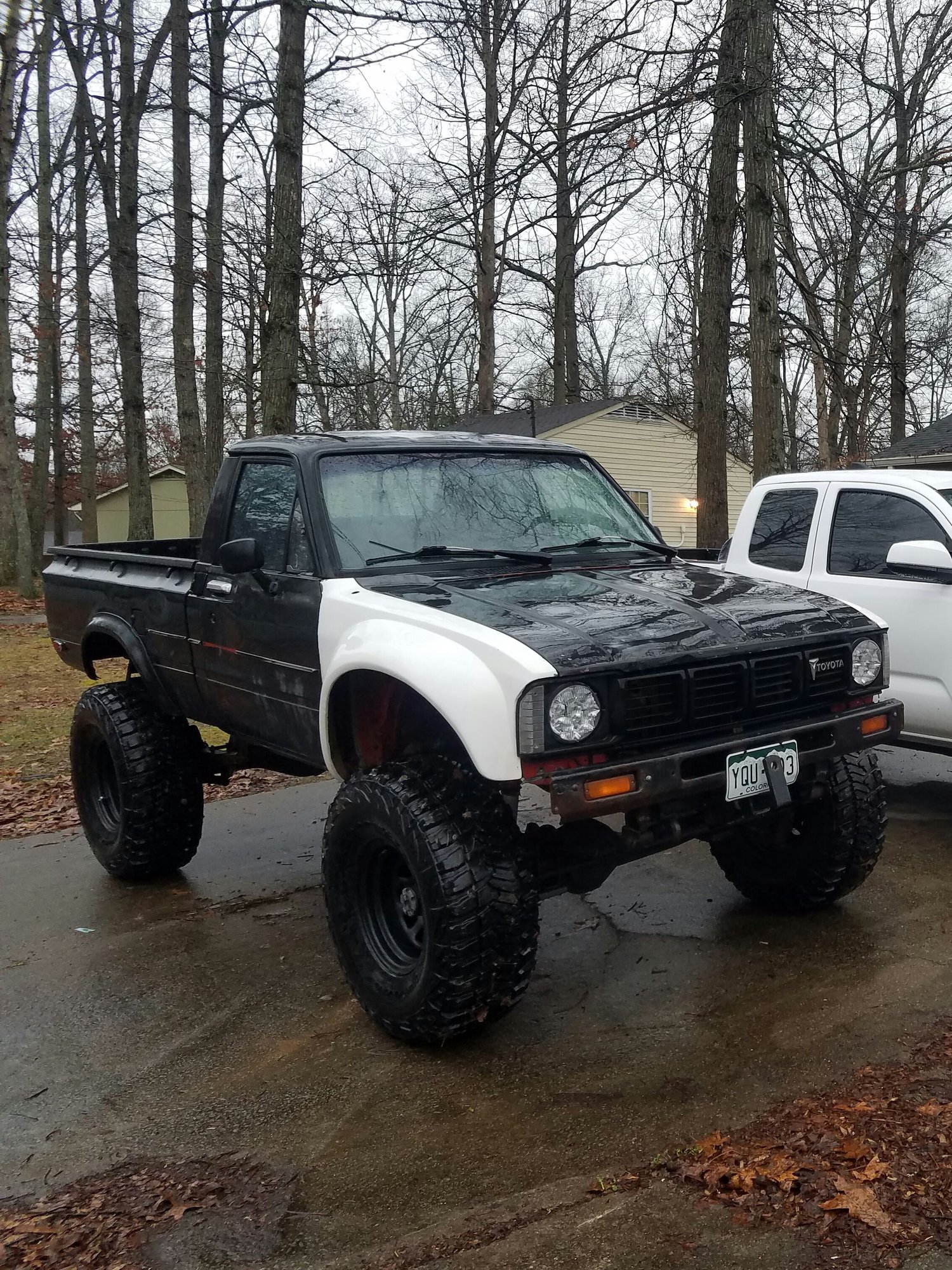

A couple of obligatory photos of my junky old truck.
