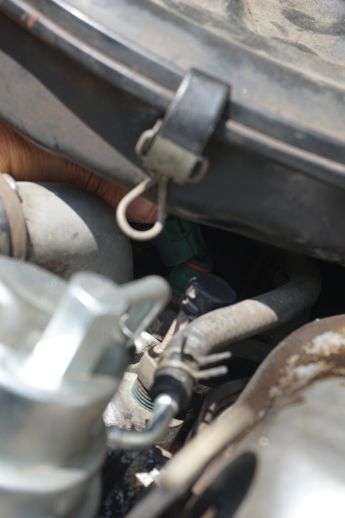

It is an 83, 4x4, 22r, carb. A buddy of mine helped me replace timing components and head gasket. Unfortunately when it warmed up it started running poorly. After poking around my buddy discovered if he unplugged the green part in image below it would run fine when warm, but poorly when cold. I think this is the SW Thermo, but not sure. Also on the diagram I looked up for an 83 it shows 2 SW thermos and I only seem to have one. I guess it is also possible that I did not get one of the vacuum hoses hooked up in the right place... we kinda forgot to label them during the tear down. I hope the pics can help. Any guidance would be appreciated. (Hope it is clear that I don't have much of a mechanical background yet, so please excuse the ignorance

1) Does any one know if Toyota switched the vacuum system from having 1 SW thermo to 2 mid 1983?
2) Will it cause harm for me to run it with this switch unplugged? (basically incomplete burn when cold, but runs fine when warm)
3) Could this switch be related to the overheating?
4) is this switch a scrap yard find or could I order it somewhere... (also it is really just called a SW thermo?)

This post won't be too much assistance, but a few thoughts that might move the thread forward.
it might help to remove your air cleaner to get a better pic of which switch you have (for example, mine has more than 1 in that area).
Also: have you confirmed your truck is either CA, CAN, or 49 state emissions equipt? The emissions placard on the hood should say. That will make a difference for the components & schematics.
