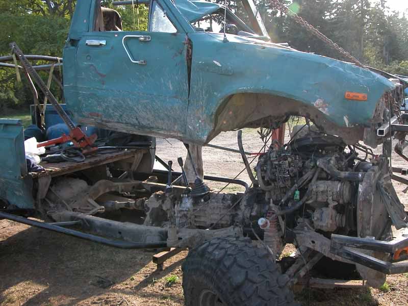

ya that looks like a comen problem. just do as most and put in a second case. but realy i would try to cut and reweld the t-case lever. i just checked my duel cases and it apeares that i put the front lever on upside down so it dosent swing fary far forwards but swings way back. my front lever toches my rear lever when im in 2wd high. maby you could just take the shift lever off and turn it 180 degres.
here is a pic my trany is in nutrel first t-case is in low second t-case is in 4wd high.
