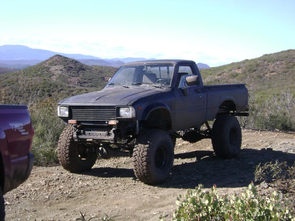

Here is my take on the body lift.
First; it came with a three inch body lift which in my opinion is large, and not something I would personally install. When three inch BL's are done, the steering shaft and shifter are welded to lengthen. I installed the one inch BL to allow clearance for the tripple sticks and not have to alter either the shifter or the steering shaft. Working in the transmission tunnel was tight in my opinion and I have just the one inch, so customizing the hole for the triple sticks was a little easier.
Second; the lowering of the center of gravity is very true. Read roger's website and he breaks it down from an engineers perspective, when done right body lifts and even axle shims are very useful and safe.
As for my truck. It's pretty much done. I took it out on a successful trial run. However my tranny has been leaking oil, and I'm going to pull it very soon, it's the seal on the input, leaking out the clutch fork arm thingie. Also the tcases are leaking as well as my power steering box. Getting a rebuild kit for the box, and I think I am going to resize my steering shaft because it barley fit. So now some slip shows. Anyone know how much slip is supposed to show? Going to probably put spacers on the wheels all the way around, prob 1.5 inches. we'll see.Ill post some current pics, also got a link to a few gopro/YouTube videos.
