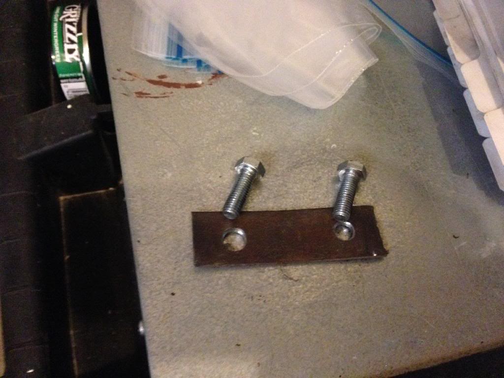

Here's my "steering wheel removal tool." Don't buy one, just drill a couple holes in a piece of flat bar at about the width of the holes in the steering wheel, get some m10x1.5 bolts and PRESTO, you've got a fancy steering wheel removal tool (batteries not included).

For the life of me, I couldn't get the wheel off myself today. Im not sure where to put the crowbar to pry it. I will check my Napa tomorrow since the one here isn't open on Sundays. Windshield wipers started working, so thanks for the advice on that.

You can make that steering wheel puller like he showed or you might try tapping in the back of the wheel (on the metal part) with the pry bad to help pop it loose.
