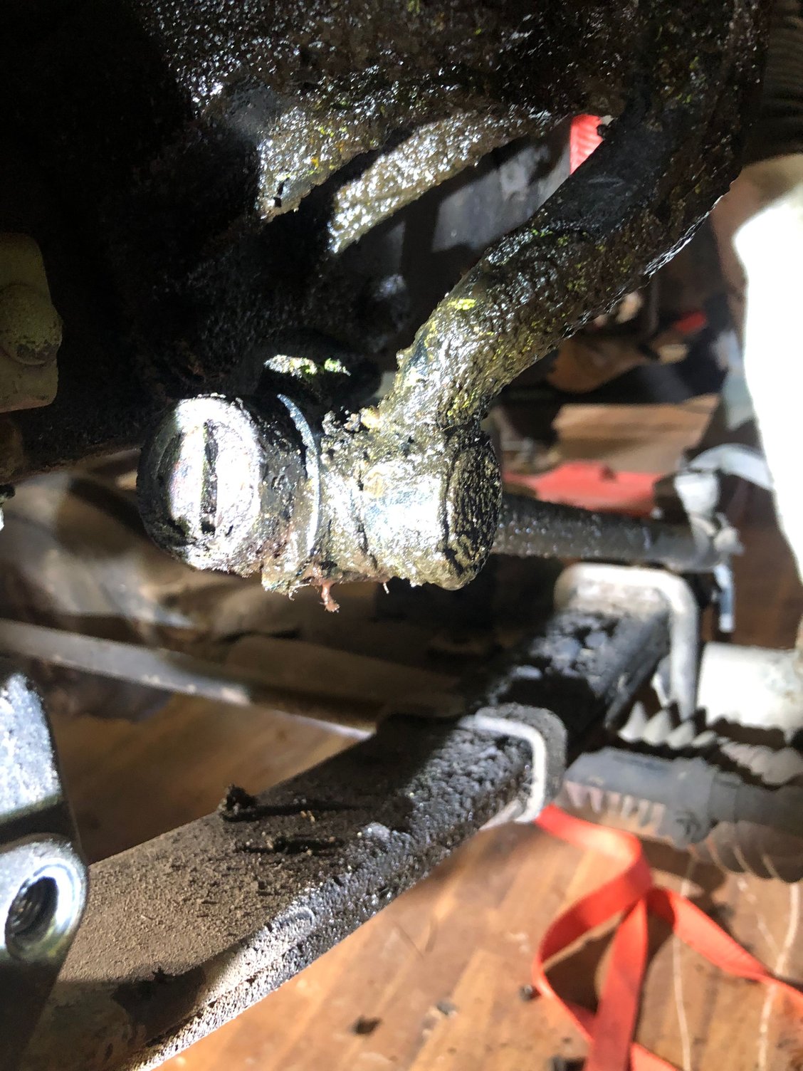

Can anyone tell me how to remove pitman arm from this? I have already removed the cotter pin. Now what??

Unscrew the big end plug with the slot in it.
When it is slack enough, the ball on the pitman arm will come out of the socket.
That part is called the drag link.

thanks!!! I got it off
