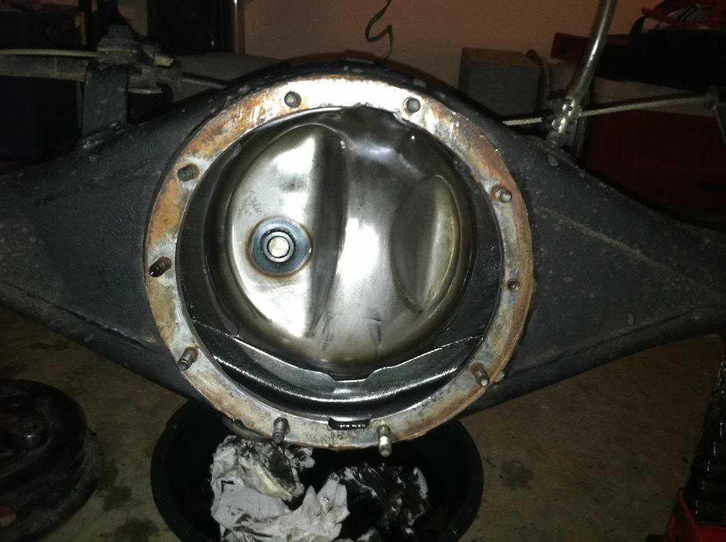

This is what I use my seals around gear oil:
http://www.permatex.com/products-2/p...t-maker-detail
Also here is some pictures
gasket scraped off:

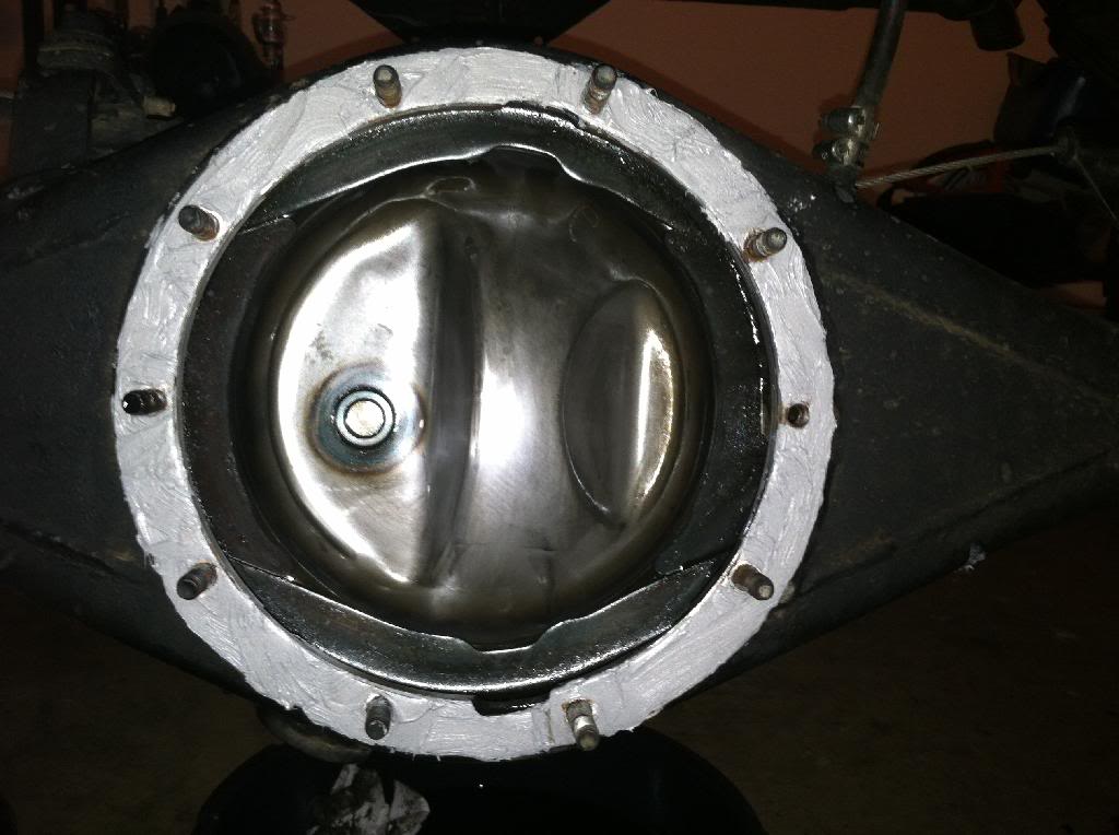

rtv on:
