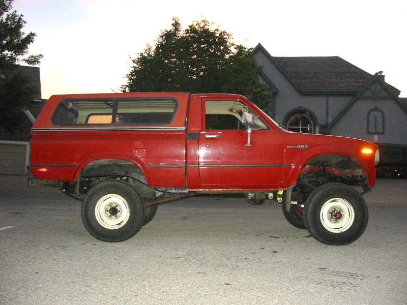

Here's mine right after I installed Alcan 4" springs setting on a set of well worn 31" ATs
