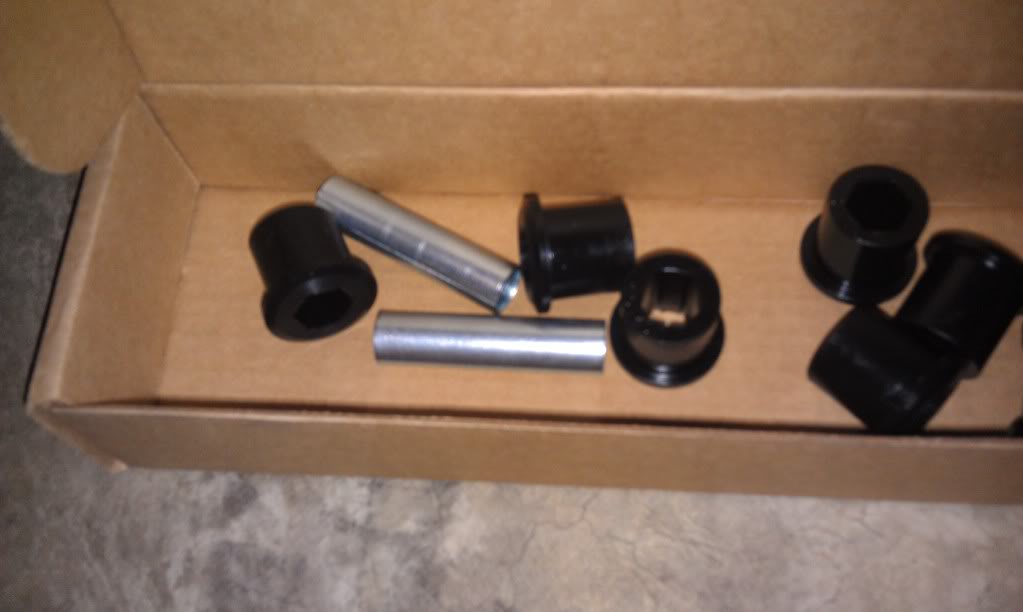

Ok I got the instructions out and read over them a few times and was looking under the truck and everything seems pretty simple. But I have two questions left. In the pic below there are two sleeves for bushings. Directions don't specify with set of bushing gets theses sleeves. What do you think? Also I was looking at the leaf springs and there appears to be a certain direction of putting them on because the part where where you u-bolt the axle onto them isn't in the middle it looks like. So would the shorter side go the the front or back, if that makes sense?

I didn't use the metal sleeves because my shackle bolts were the larger variety. If the sleeves fit over the shackle bolts then you should use them. Either way it won't matter as long as the bolts alone or the bolts with sleeves are snug in the bushings. As for the bushings, the 4 longer ones go in the rear shackle of the front leaf springs. The shorter ones go on all other shackles.
