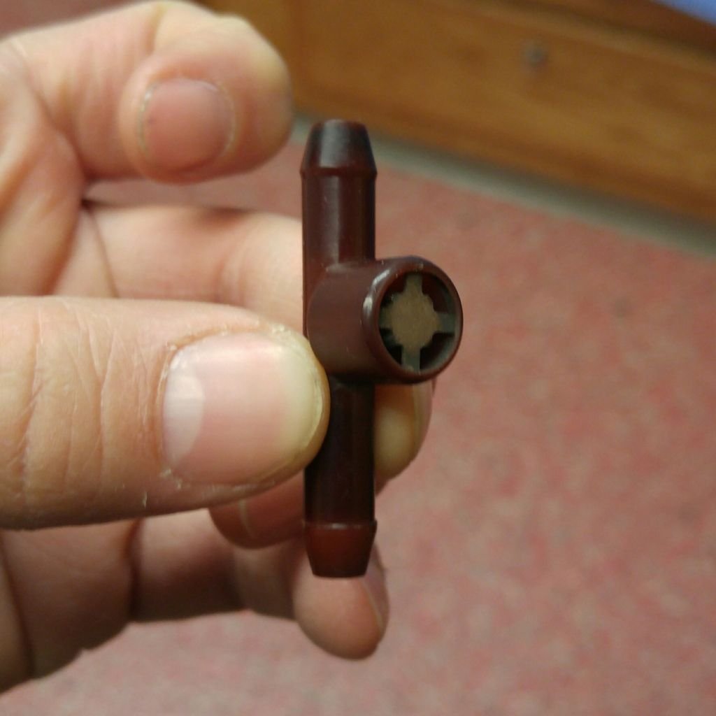

I had a stalling problem too on my '79. It would take a lot of pumping the gas to get it started but once it started it would idle pretty good but once I started driving it would stall within a very short distance, less than 1/4 mile. After trying a few other dudes I pulled the electric fuel pump out of the gas tank to check/change the strainer that's in there and I found the inline check valve (pic below) that's attached to the pump assy. I took it out and blew through it in each direction and found that whichever way I blew air was coming out of what I believe to be the pressure relief valve on the side of it. I replaced it with a small piece of straight pipe and it cranked right up. I took it for a short test drive and there no signs of hesitation or of the engine wanting to stall. So that apparently was my problem and what I think was happening was that as the pump was pumping gas to the engine a lot of what it was being pumped was going out the side of this valve and right back into the tank instead of to the engine and it would stall from not getting enough gas.
